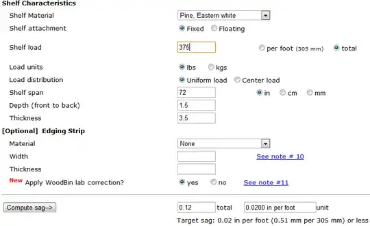

The ends are secured, so how much load can a 6' span of SPF 2x4 support when turned on 3.5"?
DANIEL THOMAS
  • 141
The Sagulator says it will support about 375 pounds (evenly distributed) before there is noticeable deflection. I recommend you go to the site, read the notes, and play around with the numbers yourself.
