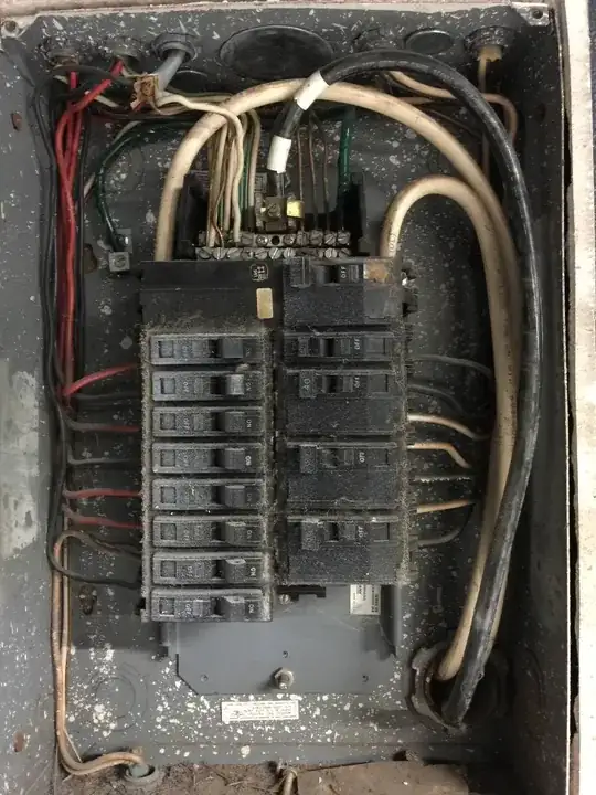

What does it mean to get two phases of a 110V outlet? Your power panel has 2 phases of power coming in, your circuits are generally distributed load balanced between these two phases. 220V in the home comes from these two phases known as L1 and L2. Your 110V outlets might be wired to L1 or L2 (never both). So in essence if you take power from a 110 Volt outlet wired to L1 and another 110 Volt outlet wired to L2 - you now have 220Volts of power. Not something that should be done but it can be done.
All of that said; here is a better option, of course this method is also for less money than that kit you are planning to buy.
Your power panel is full, so change out two of your single breakers for Tandem Breakers and this will free up space in the panel so you can add a 220V breaker.
Repair what looks to be a double tapped situation (2 conductors on one screw) on breaker [6th or 7th down on left hand side] by replacing it with a tandem breaker as well. Double Tapped breakers are a fire hazard which is why it is also a code violation. The other way to fix that is by pig tailing the two wires with a third wire which would then feed the single connection of the breaker. IMO you are in the box already changing breakers so just change it to a tandem breaker and be done with it.
Since the device you want to use is a 20 AMP device, Add the 220V 20 AMP Breaker in the newly created space in your panel.
Make sure your panels rated capacity can support the added circuit breaker amperage. This stack link should be helpful I also include the literal link just in case the link goes bad and someone else needs to do a search https://diy.stackexchange.com/questions/31604/do-the-breaker-amp-readings-sum-up-to-dictate-my-current-panels-total-possible
Now you have resolved all of your issues with a simple solution - total costs for these 4 breakers is about $50.00 at a big box. Your 220V Receptacle $10 and wiring [4 wire L1, L2, N, G] cost is dependent on how much length and gauge [#10/3 with ground] @ $1.27 / Foot ... that should put you in at just under $100 total.

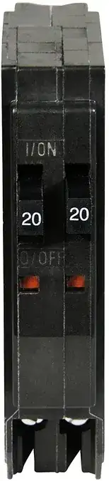

How to know if I can use Tandem Breakers:
http://www.startribune.com/how-to-know-when-tandem-circuit-breakers-can-be-used-aka-cheater-breakers/140688183/
Tandem Circuit Breaker is pictured below:
