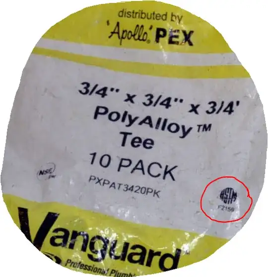

For example, Everflow fittings are documented to be "Certified to ASTM F2159". And here's a marking on a Vanguard Apollo package indicating the same: enter image description here
