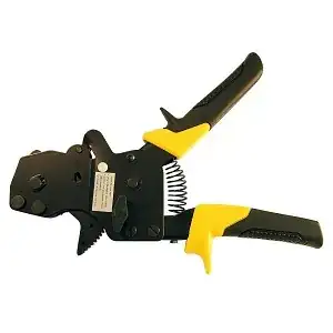

I just saw these for the first time today at Lowe's:
alt text
The advantages I can see over the crimp style are:
  1. A single tool can work with multiple PEX sizes
  2. That single tool is cheaper than a single-size crimp tool (~$40 vs ~$80)
  3. The tool grabs and pinches the raised segment of the clamp, so it doesn't need to wrap around the tube which should make it easier to use in confined spaces
Has anyone used this type of ring for PEX work and have any thoughts on them?

I just did a remodel, and ended up using PEX clamps. Got the clamps and what-nots at Home Depot. The clamp tool can be a bit of a challenge to use between floor joists, and I did indeed have to do just this in a rather awkward angle, but it worked great. Due to other issues, I had to undo a connection at one point, and peeling the clamp apart wasn't too difficult.
Being able to use the same tool for both 1/2" and 3/4" made it a wise investment. The clamp tool itself auto-releases when the clamp is fully seated, so you don't need to be a plumbing pro to use it.

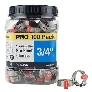

All 3 points you make are correct. I'm a DIY and bought these Pex Cinch Clamp Fasteners by Apollo to plumb my new house we were building. It's a 4500 sq ft home and I had a lot of pipe including copper manifolds. My water has been turned on for 5 months now without any leaks. It passed the air test without any issues. The only time I had a leak was when I forgot to clamp the ring on :(
As far as the comment about cheaper tools don't work... I would have to disagree when it comes to the apollo tool. I also used a copper crimp tool for 1 1/4" pipe and that thing is a beast. No doubt it's stronger and more well built than the Apollo cinch tool. However, I don't plan on dropping my tool off a 2 story building so it's good enough for me. Anyway, point being the cost/benefit ratio for the tool alone outweighs the extra cost of the stainless steel cinch rings(and yes they cost more) IMO.
The ring sits so tight around the pipe you can spin it around and it won't leak. Cinch rings are also easier to take off if you know the trick (twist the top off basically). Even after you get the clamp off the pipe is so tight around the fitting you can't pull it off. You have to cut it. This proves just how tight the ring clamps around the pipe.
I installed the pipes in and under the floor joists and it was definitely easier in confined places.
I wouldn't hesitate to use the stainless steel rings again. Don't be afraid of the newer technology.

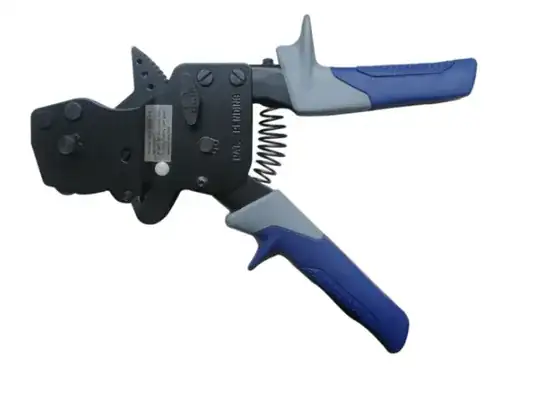

I picked up one of these yesterday:
Model # BJ0010C Kobalt Steel PEX Cinch Clamp Fastening Tool
and it works great. No problem getting it in between my floor joists, and it doesn't appear to be as finicky about keeping the tool exactly perpendicular to the tubing.

I don't have any personal experience with the copper rings but a year ago I replaced all the downstairs galvanized steel plumbing with pex using the following tool and pinch rings:
The tool is great because you can operate it with one hand and effortlessly got into some very tight spaces. It's the only tool the average homeowner will need when re-plumbing their house.

The pinch clamps with guides were a huge time saver as I didn't have to guess whether I was attaching the ring in the right place.
