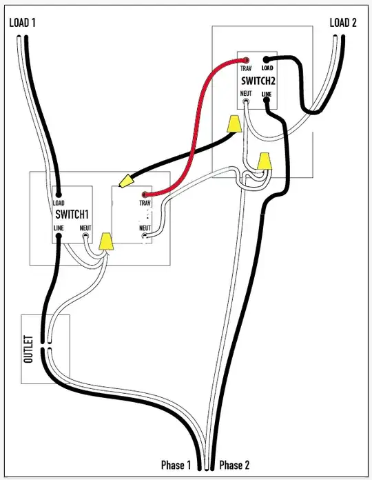

two phases feeding two switches; switches share a neutral
In the diagram you can see that there are two phases which end up in the same lightswitch box, side-by-side, and the two switches happen to share a neutral.
These two switches happen to be on different circuit breakers, on different subpanels. I happened to turn off the breaker going to the outlet (was swapping out the hardware), and found that wires coming in from the 'top' of the box were still live (and in a weird way, with the white wire measuring 119V to ground, and the black wire measuring 113V to ground, and the two wires measuring 0V between them) and capable of a full-voltage shock.
How/why does electricity flow from the 'white, with tape' wire through to the neutral, and into switch 1, and then into the black wire on the outlet?
For what it's worth, I see that I can fix this by swapping the Add-On switch with Switch2, and then sending the neutral from phase 2 over the white-tape (or black) wires into the other box.

Consider the neutral above the receptacle, to the wirenut, and on to load 1 and the two smart switches. What keeps this neutral near 0 volts? Is it the appellation 'neutral'? Is it the white color? Nope. What keeps it near 0 volts is that it's tied back to neutral at the panel. Which you severed when you removed the receptacle for servicing.
Now, absolutely nothing keeps the neutral near 0 volts. It would "float" at any voltage, vulnerable to inductive or capacitive coupling like any floating wire. Except for switch 2. Switch 2 is trying to power itself. It is trying to take power off the "LINE" wire from panel 2. It is returning that power via the "neutral" from panel 1, which lifts that neutral to 120V, as I show in the second illustration here. Your removed outlet is the X, and that's where you put your hand.

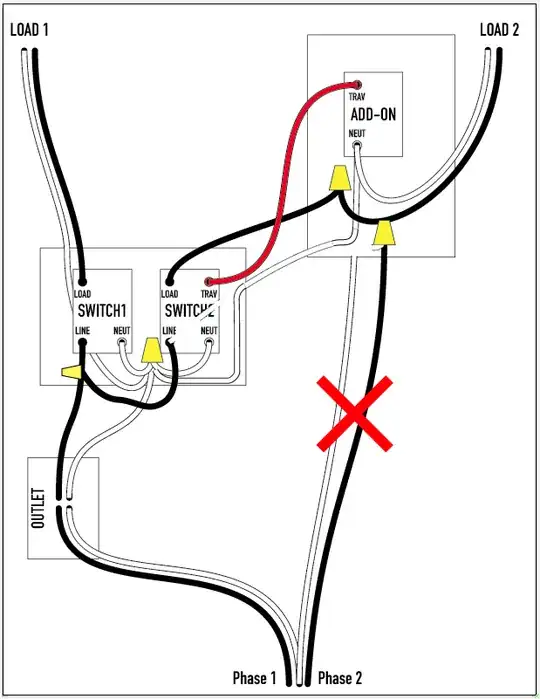

Fix 1: Feed everything from the left circuit
In this case we just cut the right power cable. SNIP! And it's gone.

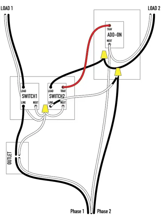

Fix 2: Feed load 2 from the right circuit
In this case we swap switch2 and the add-on and sever the neutral connection in the left box. The add-on communicates only with the black-red-white cable from supply 2.
Note the Invisible Wall between the circuit 1 stuff in the left side of the switch box, and the circuit 2 stuff on the right side. I am surprised the remote switch doesn't need an always-hot, however if needed, it's in the bundle as a spare. Also separate the ground for that extra cable - that'll make it rather obvious to the astute observer that this is served from a different circuit, since every wire in the cable goes to one device.

The problem is that the light on switch 2 was routed using the hot and neutral from circuit/leg 2, while the switch itself is powered by the hot from circuit 2 but the neutral from circuit 1, creating circulating currents that can heat metal parts and cause EMI as well as a Code violation (300.3(B)/310.10(H)). Moving the light from circuit 2 to circuit 1 fixes it:

When you broke the circuit at the outlet, the current flowing back from switch 2 that was trying to power it had nowhere to go, so you got 120V between the two neutrals in the outlet box.
