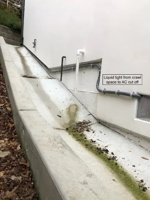

I already have 240V running about half way from my 200A main panel to my AC unit through a crawl space then some liquid tight. Here are my initial thoughts - please feel free to provide guidance here. This project is in Unincorporated Santa Cruz County. Also, please see the pictures for reference.
  1. Run ~75' of 3-3-3-5 SER from my main panel through the existing crawl space/liquid tight then run additional liquid tight from a junction at the AC unit, under the stairs, to the sub-panel.

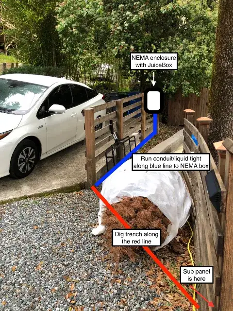

  3. From the sub-panel, run 8/3 and 12/2 underground, which will come out to a NEMA box that will house a single 14-50 receptacle, the JuiceBox, and a single gang outlet
    • How deep does this trench need to be? (guessing 18")
    • What size conduit can I use to run and bury this portion of the run?
    • For receptacles in a NEMA box, do they need to be GFCI?

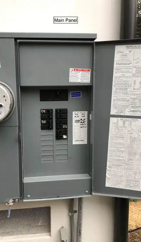

Main Breaker

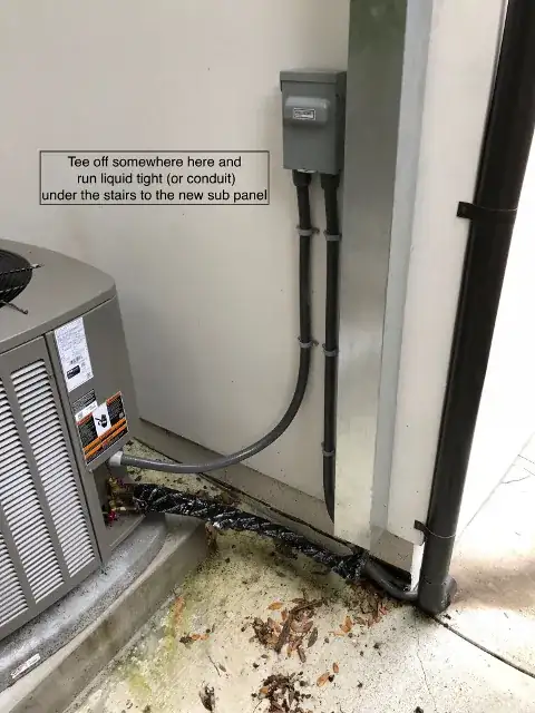

Existing liquid-tight from crawlspace to AC cut off
AC cut off

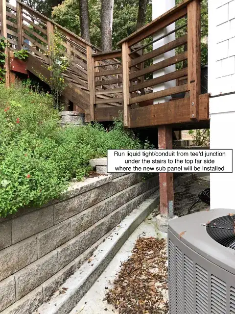

Stairs to run conduit under

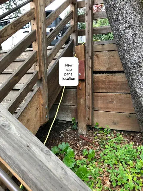

Proposed location of sub panel
Final location of JuiceBox at driveway

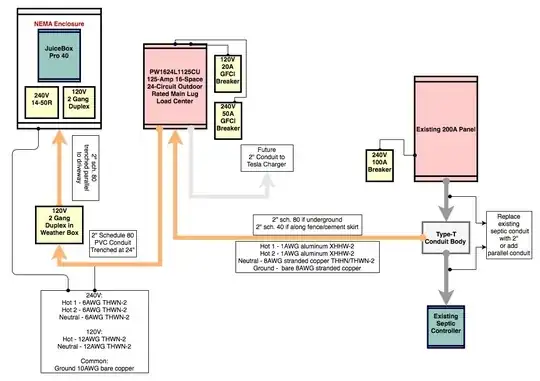

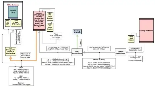

EDIT: Ok, with the suggestions from everyone, especially ThreePhaseEel and Harper. I've come up with this schematic. Anyone care to review it a bit?
A few questions:
1) When running the conduit how do you take care of lots of 90° bends? Just use Type-LB conduit bodies at every 90°? Also, when running along the side of house to replace the existing LFMC, how do you account for that small ~1" step down down along the run? Space the conduit off of the wall? (See pic 2 above)
2) I am worried about the amount of debate if aluminum vs copper conductors. Truthfully, if there is any doubt I'd rather just pay the bit extra and go with copper. If I go with copper can I downsize the suggested aluminum sizes or should I stick with the same AWG but just go copper?
3) I keep hearing about it being a pain to pull the copper through the conduit... This may be a stupid question but, can't I just feed the copper through the piece at hand and cement what I need to together as I go? Seems like this would be easy and the longest "pull" would be a 10ft straight stick? Or is the suggested method to run all your conduit, then pull the copper through?
Project Proposal Schematic: Project Proposal Schematic

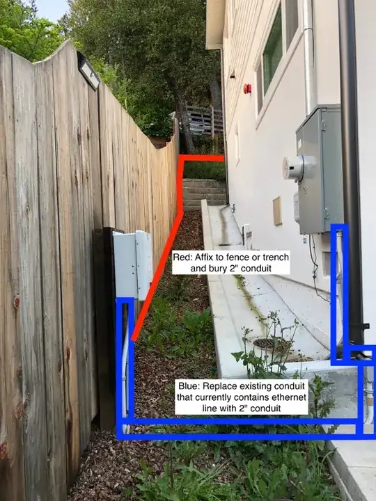

EDIT 4/16/2018:

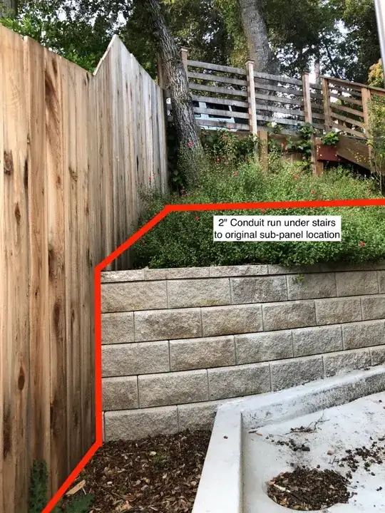

Thanks again to efforts of ThreePhaseEel and Harper and all their suggestions, I took a step back this weekend to look over the conduit plan and seems like I may have found a better way. There is a very small run of conduit that exists that feeds my septic controller's data lines (ethernet). It seems like it would be pretty easy to replace this with 2" conduit, add a T-type conduit body and run the conduit up the left side of my yard; either attached to my fence, the concrete drainage skirt, or I could trench the whole thing (manual labor is not a problem) any suggestions on best route? Also, I can run under the keystone wall and bring it up which would be aesthetically pleasing, but would definitely be some grunt work. This would make the conduit run pretty straight forward and would eliminate the need to run any SER at all and I could just run the 1-1-8-8 directly from the main 200A panel to the sub-panel. Here are a few more annotated pictures and an update schematic of the proposal:
Run conduit on the left side of the house instead Up the planters then under the stairs to original sub-panel location

I can tell you right now that that liquidtight is too small for what you want to do
The AC installer likely ran either 1/2 or 3/4" for the LFMC, depending on the size of the circuit. That's going to be no good for the fat wires you're running, which require 1" for sure if not 1.25" or larger.

You have the trench depth about right, but simply slap a fat pipe here and call it done.
Putting the short trench at 18" of cover will work (this means you'll probably want to trench to 24" so that there's room for the conduit itself), and you'll want to simply use 2" schedule 80 PVC for this (and the entire run). Don't forget the expansion fittings, though! Also, prefab wide-sweep elbows are a good idea for the transition bends between aboveground and underground, as well as the final bend before you reach the junction box.
That way, if you want to put in fatter wires when you put the Tesla charger in, you have the space to do so instead of having to go back and dig up the conduit, which is quite costly compared to simply buying fatter conduit to begin with.

As to your schematic and panel selection
There are a few issues with your choices of parts for this project, and I'll address them in turn, starting at the main panel and going downstream.
First off, there just isn't enough volume in a volume marked conduit body (the only ones you can splice in) for what you want to do with that first LB, which is why I suggested an actual box there instead. Of course, if you wish to have the box completely inside, you can use a LB to send the conduit run around the bend and then go into the box.
Second, you'll have to consider fill derates (4-6 current-carrying conductors in a conduit forces an 80% derate on you) when you put the A/C wires in the same run as the feeder. This may force a bump of the feeder hot wires to 1/0 aluminum, which adds to cost and space, as well as re-running the A/C wiring adding to your labor compared to running the new conduit in parallel with the existing run.
Third, that 1.25" PVC is probably not enough of an oversize to be a practical pull over that long stretch (even with conduit bodies to break up the bends), and following the existing run would break the 360deg limit on bends between pull points, in addition to the next-to-last bend being rather too tight (even for 1/2", you need 4" of radius-to-centerline minimum for a legal conduit bend). Using a LB instead of that next-to-last bend would fix both issues with the bend rather nicely. The first two bends in the run can also be replaced with bodies, but you need a LL and a LR for that instead of two LBs due to access issues. As to the conduit size and type? I'd go up to 2" if possible, or 1.5" at a bare minimum, and rigid schedule 40 offers no advantage here over LFMC while requiring more tooling to work with, as well as expansion fittings to keep the run from doing the worm on you.
Next up -- running 2" schedule 80 straight into a FS box (aka weatherproof conduit box) isn't going to work. You're better off using another T body there with a reducer to a more appropriate size to feed the FS, and then just running more 2" schedule 80 off to the NEMA box.
Now that we have all the concerns about conduit selection out of the way, I can tell you right now that you have the wrong panel for the job. That "3" before the "125" in your panel's model number means it's a three phase panel. While you theoretically could use it on a split-phase system, it'd be a waste of a full third of the spaces, which aren't in abundance on a 12 space panel anyway. For the same price, you can get a Siemens PW1624L1125CU instead, which gets you twice as many usable spaces (16 vs 8) and factory fitted grounding bars as well, which is quite helpful for a subpanel.
Inside the panel, you can use GFCI breakers to protect the GFCI'd circuits -- this lets you mount ordinary weather-resistant receptacles in the NEMA box, as well as in the weatherproof box at the other end of the fence. If some "home inspector" can't wrap their heads around a GFCI breaker, that's on them, not you.
As to the wires, while you can go smaller with the copper (2AWG or 3AWG copper vs 0AWG or 1AWG aluminum, depending on if you're invoking the derate rules or not), that doesn't gain you anything compared to aluminum save for a bigger hole in your pocketbook. Keep in mind that loadcenter lugs are tin or zinc plated aluminum anyway, so even on a copper buss loadcenter, it's copper that poses any dissimilar metals problems, not aluminum. Last but not least, you have to put the conduit together first and then pull the wires through it to keep the insulation on the wires from being ripped up excessively by sharp conduit edges -- this is codified in NEC 300.18(A):

As to that reroute...
While 800.133 prohibits having that Ethernet cable in the same conduit as mains wiring, what you can do is route the conduit for the feeder alongside the conduit for the Ethernet without having to worry too hard about bothersome EMI. That, and simply use schedule 80 everywhere -- it's probably not worth switching back and forth, especially given that schedule 80 is going to hold up to little oopses like getting weed-whacked or mower-bumped better than schedule 40 will.

First, reuse of the A/C conduit and liquidtight is out of the question. It's way too small. You'll have 2-3 wires pinkie-sized (heed ThreePhaseEel's advice about downsizing neutral, this is an ideal situation for that). Given the tight space it might be worth looking at putting the A/C in the new larger conduit. However that'll mean 4 active conductors and a possible derate.

Given that you're doing DIY, be aggressive about going oversize with conduit. I would run 1.5" or 2" for the big 100A run, just to make the fat wires easier to pull. Nothing is more frustrating than saving a few bucks using smaller conduit, only to run out of swear words, and having to call in an electrician just for his pulling tools.
With conduit, you can only have four 90 degree bends (360 degrees worth of bend) between access points. You'll want a lot less than that for an easier pull. You can put "conduit bodies" at corners, this not only provides pulling access, but makes corners sharper.
For the underground conduit, rigid conduit only needs 6" of cover if you are not going under a driveway. It's the most expensive conduit, but your run is really short, so it hardly matters. Again I'd err on the side of big for easy pulling. Rigid must be cut and threaded to length, so include a hardware store in your commute.
Rigid also counts as a ground path, so that'll be two less wires. (well, circuits out of the same panel can already share grounds, so one). Under the circumstances 3/4" should suffice. 1" will be easier to pull especially if you add a ground wire.

On your edits...
It looks like you want to transition from cable to wires in that LB conduit body. You cannot splice in a conduit body. Period. (insert two pages of rules and exceptions that add up to: Period.) Run the conduit a bit farther into the house and terminate it at a nice fat box. Splicing two #0s, two #8s and three #10s you'll need a lot of room. I would use inline splices on the #1 / #0, and guess what, those will be made of aluminum. Alternately you could continue the conduit "home" and not have to splice at all.
The type "T" conduit body will be fine, as wires will only diverge, not splice.
I handle large numbers of 90 degree bends by putting access points at some of the bends. A conduit body will suffice, since you're not splicing in it. Ideally I aim for no more than one 90 between each access point. So for instance you might put conduit bodies on outside corners and curved conduit at inside corners.
DON'T thread the conduit over the wire. If it's hard to pull, your conduit's too small. The incremental cost for bigger conduit is pretty negligible compared to total project cost. If you need to downsize conduit due to a clearance etc., they make up/downsize nipples that screw into a conduit body. There are "straight" conduit bodies too.
If you're going to use PVC conduit, give it a year and if it shows the slightest sign of hazing or fading, scuff-sand and paint it with Rustoleum alkyd (oil). Use $1 throwaway brushes to paint it, and trash the brush rather than trying to clean it with thinner, which is pure VOC. Don't paint on a spare-the-air day.
In your sections carrying 2 circuits in 1 conduit, aside from all other limitations, you also cannot exceed 80% of the 90C column from table 310.15B16:
  • 12AWG Cu -- 30A*0.8 = 24A
  • 10AWG Cu -- 40A*0.8 = 32A
  • 8AWG Cu -- 55A*0.8 = 44A
  • 6AWG Cu -- 75A*0.8 = 60A
  • 3AWG Cu or 1 AWG Al -- 115*0.8 = 92A -- uh-oh
  • 2AWG Cu -- 130A*0.8 = 104A
  • 0AWG Al -- 135A*0.8 = 108A
That #3/#1 derate might be a problem, which is why I suggested to consider carrying the A/C in a separate conduit.
