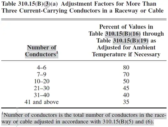

However, I was doing some re-reading of the NEC (2011 version), and recalled the need to de-rate ampacity of conductors where spacing is not maintained (such as in an EMT raceway) for runs greater than 24" per clause 310.15(B)
Per 310.15(B), it appears that the max ampacity for the wires is now only 92A and that I will not be able to use the single run of 2" conduit I had planned and instead will need to run three completely separate runs of EMT to allow for the three 100A subpanels with the 3 AWG wire I was planning to use -- is this correct or is there something else I am missing that would make my original plans okay?

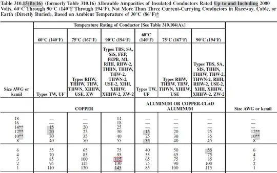

  • 3 AWG THHN with 90 degree rating = 115 A allowable ampacity per Table 310.15(B)(16)
    NFPA-70:2011 Table 310.15(B)(16)
  • 6 conductors in the same conduit = 80% allowable ampacity per 310.15(B) (relevant sections quoted below)
    NFPA-70:2011 Table 310.15(B)(3)(a)
    • +6 conductors => 3 sets of 2 out-of-phase hot wires
    • +0 conductors => 3 sets of 1 neutral carrying the unbalanced load (per 310.15(B)(5)(a)
      310.15(B)(5)(a) A neutral conductor that carries only the unbalanced current from other conductors of the same circuit shall not be required to be counted when applying the provisions of 310.15(B)(3)(a).
    • +0 conductors => 3 sets of 1 ground wire (per 310.15(B)(6)
      310.15(B)(6) Grounding or Bonding Conductor. A grounding or bonding conductor shall not be counted when applying the provisions of 310.15(B)(3)(a). (b) In a 3-wire
  • 115 A * 80% = 92 A

What you're missing is you get to round up on breaker size
92A. They don't make a 92A breaker.
95A. Oh, they don't make one of those either.
OK, 100A breaker. Done.

Indeed, when computing the derate under 310.15b3a, you disregard neutrals. But why? Because there is no configuration where the 3 conductors will be worse than 2 conductors - usually they'll be better. It's all about heat, and heat is the square of current. Say 100% usage makes 10,000 heat units (100^2).
  • If power is split 100% on L1 and L2 and 0% neutral, that's 10,000 heat units x2 for 20,000.
  • If power is split 100% on L1 and neutral, and 0% on L2, that's 10,000 heat units x2 for 20,000.
  • If power is split 100% on L1 and 50% on L2 and neutral, that's 10,000 plus 2x 2,500 heat units, for 15,000.
In a similar vein, since your supply is only 200A, your worst case load is actually four conductors carrying 100A and all others carrying 0. There's a case to make to your AHJ to let you rate for 4 conductors instead of 6. Of course this doesn't help here, but it would if you added a fourth or fifth 100A circuit.
Now with the ratings, it's important not to get tangled up. The 310.15b3a multi-wire derate always comes off the highest thermal rating of the wire type in the ampacity chart, even if you have 60C terminations. Then separately, the wire/termination temperature columns come into play. The lowest number applies. And then even separate from that, is any upsizing of the wire for long distances. And separate from that any statutory limits like "20A on 12AWG". So suppose you have 12AWG wire going 200' but traveling with 1 other circuit in a conduit:
  • 24A based on 80% derate due to 4 active conductors off the 30A in the 90C column
  • 25A based on wire and terminations are all good For 75C
  • 15A recommended to limit voltage drop given the long length
  • 20A as a hard rule since it is 12 AWG wire
The final answer is 20A mandatory, with 15A recommended to limit voltage drop.
