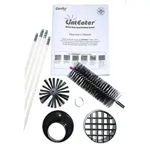

They make Dryer Vent Cleaning Kits for this very purpose:
Kit Picture
