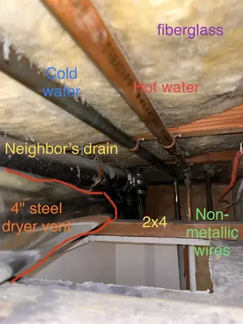

To be specific, I'm hesitating between
  1. passing the duct over the 2x4 and left of the drain ptrap (which appears to be cast iron, supported by steel strapping and with rubber hose-clamped gaskets). There is no clearance there, the pipe has to be slid over the 2x4, squeezed oval a bit to clear the drain (but not to the point of kinking), and has to remain perfectly horizontal. I could maybe make a 1/2" notch in that stud if I needed to add insulation (it's not load-bearing, it's just framing for the bulkhead that hides all this mess).
  2. passing the duct on the right side of the drain's ptrap, and left of the pipe. Barely any clearance there, but it feels odd to pass a hot pipe right next to cold water. I'm (perhaps overly) concerned about condensation.
all around the vent
  • I'm in Vancouver BC,
  • The existing vent goes straight out the building side wall (4-5 feet away). I'm re-routing the parts of the vent that are indoors.
  • It's in a ceiling / bulkhead.

There's a maximum length (incl. accounting for elbows), code for how it should be assembled (tape, no screws) and code for how it can penetrate the exterior wall and vapour barrier, but no code for clearances or slopes, also none for insulation in the mildest of climate zones.
There is separate code for how and where you can notch joists and studs to accommodate the pipe. This is for BC, Canada.
However, electrical cable cannot touch the hot pipe, and insulation or clearance for the cable is required.
If you could be more specific about what clearance you need further information about for your case, perhaps someone else can chime in with the pertinent (building) code.
As an aside, dryer vents are usually aluminum; round HVAC ducts can be aluminum or galvanized steel, and rectangular trunk ducts are galvanized steel.
