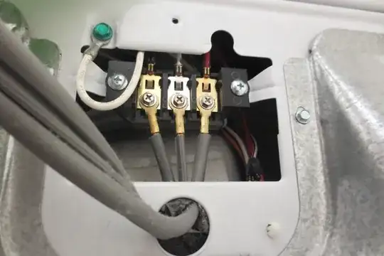

I have a new outlet (in an older house) with 4 hole socket and an older (4 years old) dryer. The dryer currently has a three pin plug.
What are my options for connecting the dryer to the newer outlet?
I did see New dryer, old outlet and How do I connect a dryer with a four prong plug to a three prong socket?, and I guess my question is just the reversed.
Is there a type of adapter that would work for this?
EDIT: With the accepted answer, I think I figure it out. The before picture:

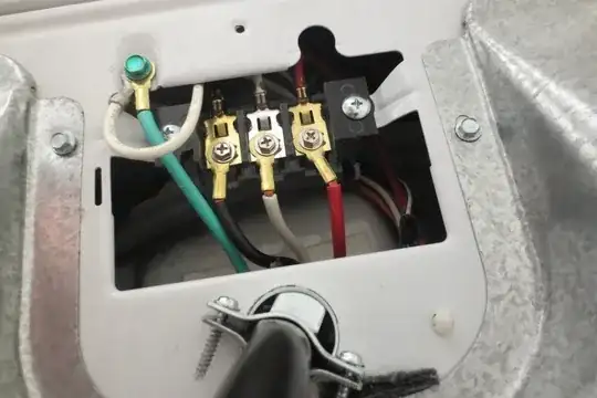

The after picture with the 4 prong cord:
Does that look right? (The colors of the wires in the cord match the colors of the wires inside the dryer.)

You need a new dryer cord, not an adapter
What you need to do is remove the existing cord from the dryer (dryer cords attach to a terminal block on the dryer, typically accessible by removing a cover from the back panel) and attach a new, four-prong/four-wire dryer cord to the terminal block. There is also a white wire running to the chassis ground screw on your dryer -- that wire needs to be moved from there to the neutral screw on the terminal block, thus disconnecting the neutral-ground bond on your dryer.
