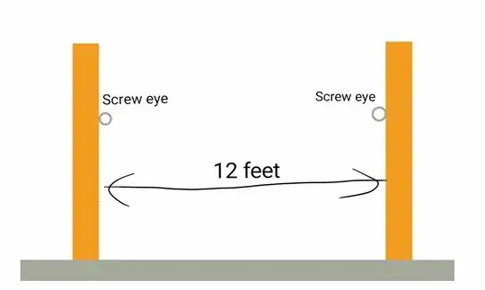

I have two 4-ft x 4" x 4" wood posts, and each post has a screw eye. There's 12 feet of distance between each post.
How can I tighten a piece of 1/2" diameter rope that goes through each screw eye and it's stretched tightly without having to buy turnbuckles?
There has to be a knot just for this.

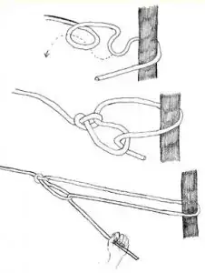

Use a simple cinch loop (a.k.a. trucker's hitch):
  1. Connect to the first eye and tie a small loop about 2/3 the way across the span.
  2. Run the tail through the second eye and back through the loop.
  3. Pull the tail toward the second eye to create the desired tension and pinch the tail to maintain position.
  4. Tie off the tail at the loop.
Source
The key here is the pulley effect, which compounds the user's strength, and the friction of the assembly, which helps hold position while tying.
Turnbuckles are a poor way to tighten rope. Most rope has far too much stretch for the range of adjustment a turnbuckle offers.
Tautline hitch is what we used in the Boy Scouts (also suggested by Ed Beale in comment above). Worked well, held when wet (with ordinary rope, including nylon; probably works with polypropylene too, but I've never tried). Does not work with monofilament, but you're not using that...
