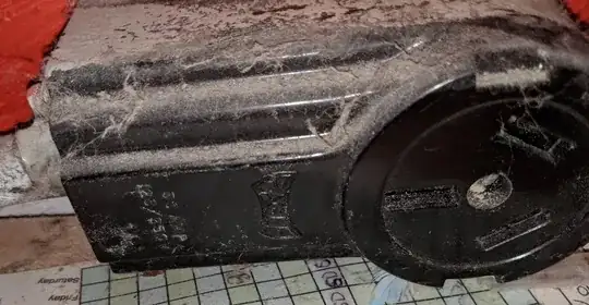

There is an electric stove plugged into this outlet. I can't tell what plug it is to make an adapter for car charging.
photo of outlet
This is in the U.S.

It looks like a NEMA 10-50 all right, but it is labeled 30A.
Electrical Code 110.3 requires you obey labeling and instructions on every device. Therefore, this mismarked device can only be breakered 30A, but anything you'd plug into it will pop a 30A breaker. It is useless and must be taken out of service and tossed. It may not even be a Proper NEMA connector, so a 10-50P may not even fit. Not that you should be using a NEMA 10 to charge an electric car! It invites a shocking situation.

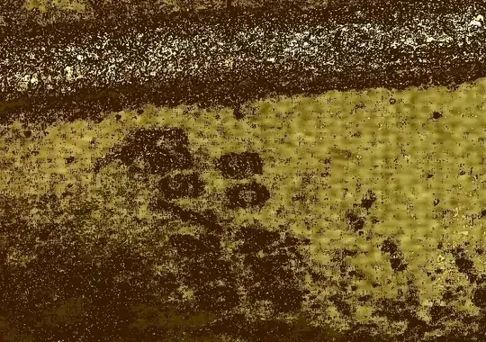

That is clearly a 5, not a 3 before the 0. It’s not mismarked. Use a standard NEMA 10-50R.
I just filtered and brightened and sharpened and zoomed your picture. Even without all that if you look closely you'll see that the dirt and fuzz makes it look like a 3. 5s usually have a flat top and 3s a curved one.
