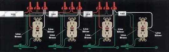

And a I have a related question as to why this circuit (shown below) doesn't continually trip the GFCIs.
from the Complete Guide to Home Wiring
My Question: Here's an example--a toaster is plugged into the 2nd receptacle from the left, drawing 5A. I assume that 5A will then flow through the neutral. Therefore, 5A is on ALL the neutral wire in the diagram, because they're all pigtailed together.
If that's true, now the 1st GFCI from the left will sense a difference of 5A and should trip because no current is flowing through its ungrounded (red) wire, but 5A is flowing through its neutral.
So, why doesn't a load on any one of the GFCIs trip all the other GFCIs? Why does this work? I know this is correct because its published, but I don't understand why.

A GFCI can only sense a difference in currents which flow though that GFCI.
In your example, the current for your toaster flows through GFCI #2, but completely bypasses GFCI #1 (and #3 & #4).
The other GFCIs are not 'aware' of this 5A toaster current, because current flowing in the neutral wire doesn't flow through these GFCIs.

You have hooked up these GFCIs exactly correctly. This the way to do it.
The notable thong about your install is that you did not remove any of the tape from the LOAD terminals, and did not connect those terminals. That is what made this installation so safe and sure.
Now, why doesn't it trip on the shared neutral? Because the neutral isn't shared to the GFCI. Every GFCI is providing a "zone of protection", so you have four zones of protection. For each GFCI+receptacle combo device, the only thing inside its zone of protection is its own sockets. That's because you didn't use the LOAD terminals.
