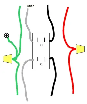

Here's a diagram of how the non-GFCI receptacle is currently wired, in my best 6-year-old artistry: diagram of current receptacle connections
I think it's connected this way so that each receptacle in the kitchen has their two sockets supplied by different breakers. At the service panel the circuit is controlled by a joined pair of 15A breakers. I assume the white and black are separate 15A lines and the red is a common neutral (?).

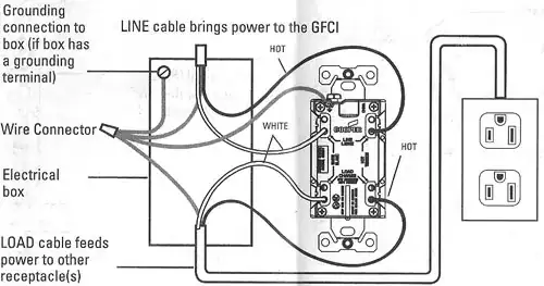

Here are the instructions for connecting in a 2-wire scenario.
How do I connect this? Or should I consult an electrician?

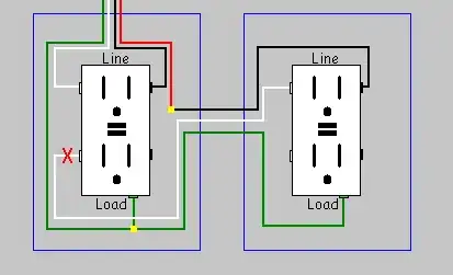

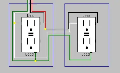

You can share a neutral between 2 GFCI receptacles. The catch is you'll have to pigtail the neutral to the receptacles, not use the neutral from the load side of the first GFCI to feed the second.
So you should be able to do something like this...
But not like this...

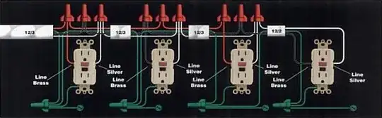

You'll then be able to use the load side of each receptacle to feed other devices, like this.
Most of what Gregmac has said is correct, however I have to correct a couple of small items. It is totally acceptable and often done to use a three wire circuit (black/red hot, white neutral & bare ground) like you have to "alternate" kitchen receptacles, thus giving you two circuits. It is not a code requirement to split the top and bottom of the recpts, however it is fine to do that, but it complicates the GFI functions. Splitting the top and bottom would require two GFI's upstream, one feeding each of the legs. More common would be two single pole GFI breakers in the panel.
With that said, your situation is different. I bet you will find that the the black feeds every other recpt, and likewise the red does the same thing with alternate recpts. Once you confirm that, simply install a GFI on the first powered recpt of each string (color). As a matter of fact, this is the most common way kitchens are wired and meets NEC.

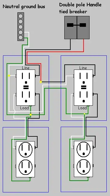

This "shared neutral" circuit is actually one circuit called a Multi-Wire Branch Circuit or MWBC. You must comply with their rules.
Rule: You must pigtail neutrals. You can't use the 2 neutral screws to daisychain through the receptacle as you illustrated.
Shared-neutral circuits must use the same 2-pole breaker
(Okay. There's an exception involving handle-ties. But ignore that, because this segways into a very helpful thing!)
The two "hots" that share the neutral must be landed on a 2-pole breaker. This 2-pole breaker assures common maintenance shutoff (an MWBC rule) and that the hots are on opposite 120V poles (a very absolute MWBC rule).
Protect a shared-neutral with a 2-pole GFCI breaker
As it happens, they make 2-pole GFCI+breakers, which accept 2 hots and a neutral. And that's what your cable is.
You fit the 2-pole GFCI breaker, attach its neutral pigtail, and bring all 3 wires: both hots and neutral to the GFCI breaker. And you're done.
This will fully protect any legal configuration of MWBC/shared neutral circuit. You don't have to worry about how neutral is shared and firewalling line from load. It just works.
"Oh, but 2-pole GFCI breakers are expensive" -- so are four GFCI+receptacles, as you show in the drawing in your edit.
If you must use many GFCIs - just don't use LOAD
If you absolutely insist on using GFCI+receptacle devices, well.... okay. You can do as in your last drawing (in your edit).
This makes it a very simple rule: Don't remove the warning tape from the LOAD terminals. Simple as that. Of course, you'll be sitting there tempted, right? 2 wires in your hand and 2 screws you can't use--- nuh uh don't touch that tape! You have to figure it out another way. Hands off!
This will lead you to a concept called pigtailing, which I remind you, you need to do with the neutrals anyway because of MWBC rules. So, now you're doing it with the hots too. Pigtail every connection onto the LINE hot and neutral, and voila. You have GFCI protection everywhere you choose to fit a GFCI+receptacle. And it didn't explode your brain.
