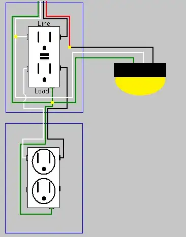

I have a pool to protect correctly. There is a 12/3 wire: red serves the receptacles at the bottom of the pole lights and the black serves the pole lights. Now they are on two separate breakers. I was going to put a single pole GFCI on the receptacle line but I know that I can't share the neutral.
I see 3 options:
  1. Can I put both the red and black on the same single pole? I think it is against code but would it work? I don't need the 20A for lights and the outlets.
  2. Is the double pole option with the single ground right?
  3. Wire the first outlet in the series with a GFCI .... but I'm not sure that works because the pole lights after it again share the same neutral.
I'm not pulling new wire ... It's underground.

Single GFCI Receptacle
The next option would be to install a single GFCI receptacle to protect all the downstream receptacles, and leave the lights unprotected. Though you'd have to check your local codes to know if the lights need to be protected.
Just remember, you'll have to pigtail the neutral before the GFCI receptacle for this to work.

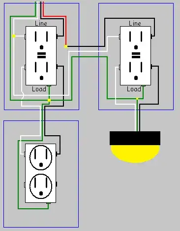

Two GFCI receptacles
The other option is to install a GFCI receptacle to protect downstream receptacles, then install another GFCI receptacle to protect the lights.
Again, you'll have to pigtail the neutral before the first GFCI receptacle. This also has the disadvantage of having a receptacle on the light circuit, which can lead to overloading the circuit and standing in the dark because of it. However, it does insure both legs of the circuit are protected. You could install the GFCI receptacle that protects the lights in an inconvenient location (while still keeping it accessible for resets/tests), to limit the temptation to use it.
