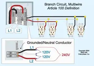

If it's a 4-prong receptacle, then you could do it. Though you'll have to swap out a breaker in the panel. This will leave you with a 20 ampere multi-wire branch circuit (MWBC), which can be used to supply countertop receptacles.

Multiwire circuit

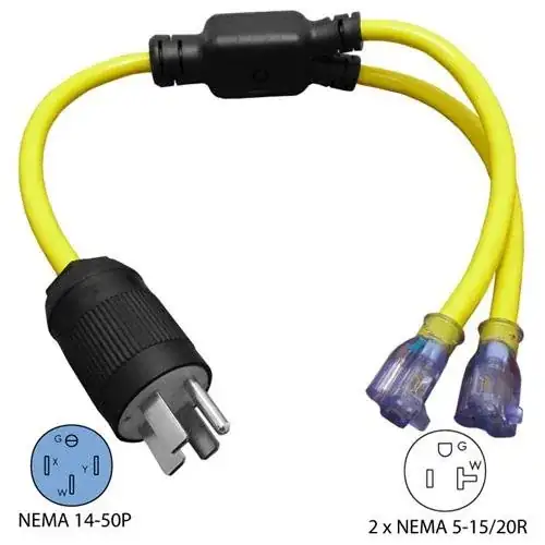

Here's hoping you have an 14-50 (4 prong outlet) and not a 3 prong. Buy one of these:

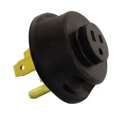

But to answer your question, to do this without touching the breakers or the wiring, here is a device that would provide one 120v outlet. There may be similar devices available that provide more outlets:
Gas Range Adaptor
Mfg: Woods
Model: 548301
It doesn't appear to be UL Listed, but specifications indicate it has a built-in 15 Amp fuse, and it is CSA (Canada) Certified.
The important thing is that it is protected from overload by a fuse.
Woods Model: 548301, 220-Volt to 110-Volt converter
