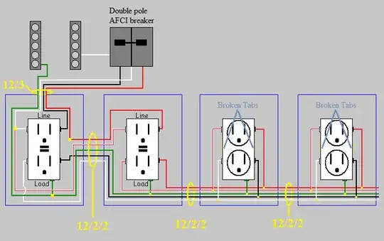

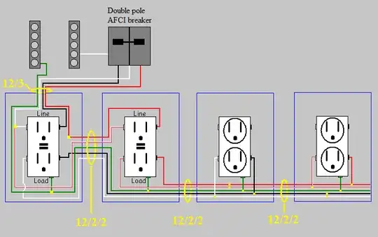

If you can't find a dual function circuit breaker, and you have to use separate GFCI receptacles on an AFCI protected circuit. You can use a combination of 12/3, and 12/2/2 cables. 12/2/2 cable contains two ungrounded (hot) conductors (black, red), two grounded (neutral) conductors (white, white with red stripe), and an equipment grounding conductor (bare copper). You'll wire the circuit like this.
AFCI protected multiwire branch circuit with GFCI receptacles
Pay close attention to the wiring of the grounded (neutral) conductor at the first GFCI, as to avoid sharing the grounded (neutral) between GFCIs.
In a scenario like this, you could break the tabs on both sides of the receptacles, and feed the top and bottom of the receptacles with separate circuits. For example, all the bottom plugs could be circuit1, while all the top are circuit2. This would be wired like this.
