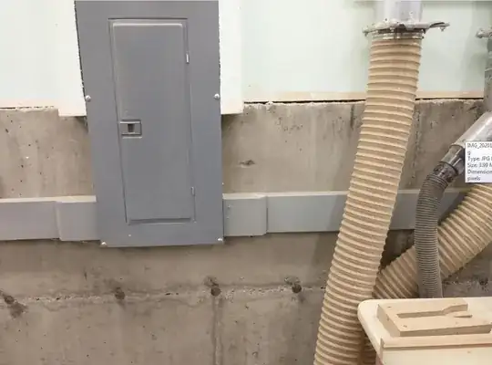

When I built my shop, I used surface mounted Wiremold 4000. But because my shop is partially earth sheltered, I have very high (4.5') stem walls. I went with the raceway because shops are often "evolving" with new tools, changed layouts, evolving requirements, etc. Conduit would be less forgiving. So now when electrical needs change, all I do is pop off the covers and run whatever wiring is needed to the sub-panel, install the appropriate outlet and pop the covers back on. This may be over-kill for your needs, but wanted to let you know what I did. Also attached is a pic of the actually installation in my shop (wood-working oriented).

Wiremold 4000 Actual install of wiremold 4000
