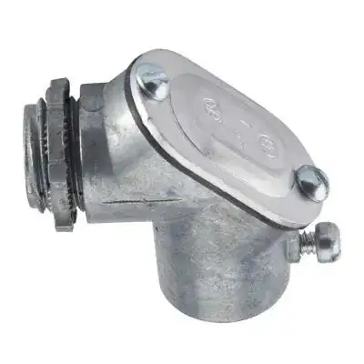

If you really don't like the idea of boxes at different heights when you backtrack - you could enter the tops of the boxes on the left and exit on the right with pull elbows...
pull elbow
... or, you could run the conduit down at baseboard level and stub 90s up into the box left and right. That might look a little nicer. You get the idea, you can get creative.

Extend some new conduit out of that knockout (using an LB, LL, LR or pulling elbow to round a 90 corner if need be). Mount the new box so this new conduit goes straight into it.
