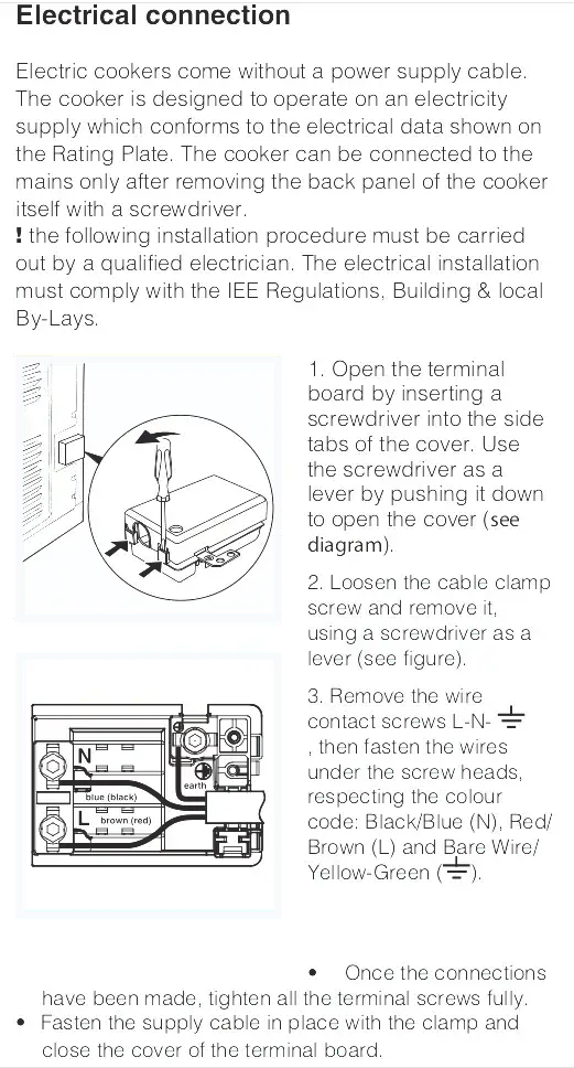

this is the model I have
The manual for the Indesit I6VV2A(W)/UK Cooker contains these instructions:
Electrical connection instructions
So the cooker is not supplied with a cable and plug. It should be hardwired to am electrical circuit that matches the rating plate. I expect it needs a 230V 32A dedicated circuit with a two-pole isolation switch accessible on the wall near to it. In the UK it would be connected through a Fixed Connection Unit (FCU) not using a plug. Things may be different in the Netherlands so I would suggest consulting an alectrician.
You cannot separate the hob from the oven or disable the hob in this Indesit 16VVA2.
Can I somehow make that kind of connection using mutiple normal power sockets?
No. Absolutely not.
