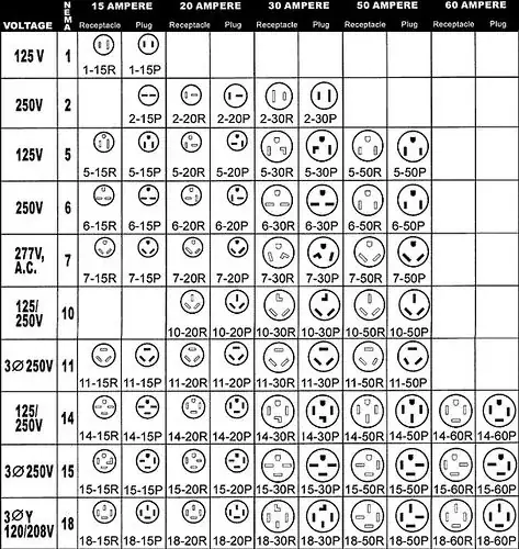

  1. Diagrams like this suggest that US householders need to know about more than one type of electrical socket. Diagrams like the one below are even more intimidating. Clearly households in the USA typically have only a few of these, and presumably the 1-15 and 5-15 types comprise the majority of outlets in a home. But which others might be encountered? enter image description here

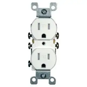

The vast majority of outlets in residences in the US are attached to branch circuits that are rated at 15 Amps and 120 Volts. Current practice and code calls for outlets like these
outlet
This version is tamperproof, required in many jurisdictions. The non-tamperproof look similar, but the slots do not have internal baffles

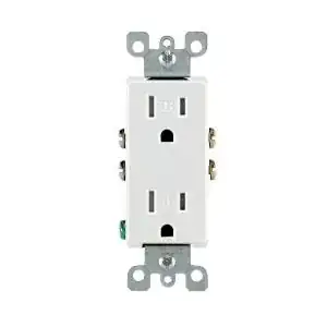

You may see different styles, such as Decora, or decorator style, which are functionally identical to basic outlets, but have a rectangular face
decora outlet

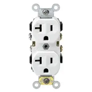

20 Amp circuits generally require slightly different outlets (if you are going to draw the full 20 Amps or there is only one outlet on the line) like these
20a outlet
But you can also find the lower 15 Amp outlets on circuits that are properly wired for 20 amps. Obviously 15 Amp outlets are limited in use to 15 Amp appliances, even if they are on a 20 Amp line.

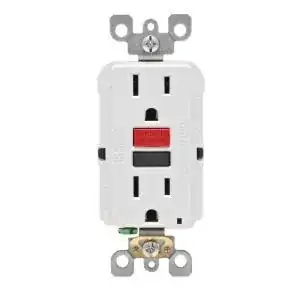

Certain locations, especially where there is a risk of moisture, such as bathrooms, require a ground fault interruper (GFI) type outlet
gfi outlet
These also come in tamper resistant and 20 Amp versions and vary like the basic outlets.

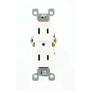

All of the above are grounded outlets, required in almost every jurisdiction for new construction and renovations. Some older installations may have ungrounded outlets.
ungrounded outlet
These generally cannot be used except as a direct replacement for an existing one, and even then setting up a properly grounded outlet is preferred and may be required.

Some residences use higher amperage outlets for large appliances, such as an electric stove or dryer, and the outlets vary base upon a number of factors. Examples can be seen in the chart linked in the question.
Similarly, some residences use 240 Volts for large appliances and wells, and the outlets also vary considerably, and can be seen on the linked chart.

NEMA
First let's take a moment to understand what NEMA is, and how it relates to receptacles and cord-and-plug appliances. National Electrical Manufacturers Association (NEMA) is a standards organization, that creates standards for electrical equipment.
Each standard has a number associated with it, so you may see something like NEMA 5. That simply means that any device that conforms to standard 5, will display the characteristics described in the standard.
When dealing with receptacles and plugs, you'll often see something like this NEMA 1-15. The number after the dash represents the maximum current rating of the device. So in our example, the device would have a current rating of 15 amperes.
You may also see an R or P, following the current rating. This simply denotes whether it's a receptacle (R), or plug (P) (Where "Plug" means the actual device at the end of a cord that connects to a receptacle. Not to be confused with the receptacle itself, which is often known as "outlet", "plug", or some other slang term).

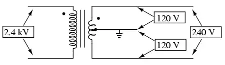

Distribution
The most common distribution system in the United States, is the single split-phase system. Though 3-phase distribution can be found.
120/240V
In a split-phase system, electricity is transmitted at high voltage from the power producer to a local distribution station. The high voltage electricity is stepped down to ~240 volts, using a step down transformer. The transformer has a center tap on the secondary winding (this is why it's known as "split-phase"), which allows a supplied voltage of 120 volts. The cable supplying electricity to the home, will be made up of 3 conductors. Two ungrounded (hot) conductors, which have a 240 volt potential between them. And one grounded (neutral) conductor, which has a 120 volt potential between it and either ungrounded conductor.
120/240V transformer configuration

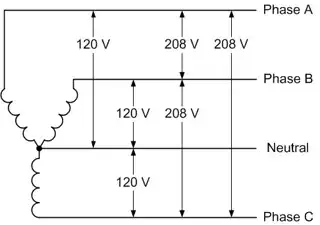

208Y/120
In a 3-pahse system, 4 conductors will be supplied to the building. Three ungrounded (hot) conductors, which have a 208 volt potential between themselves and any other ungrounded conductor. And one grounded (neutral) conductor, which has a 120 volt potential between it and any of the ungrounded conductors. Each ungrounded conductor is 120° out of phase with any of the other ungrounded conductors, which is why it's known as a "3-phase" system. This is a less common form of residential distribution in the US, but it can be found in some places (more common in rural areas).
208Y/120
