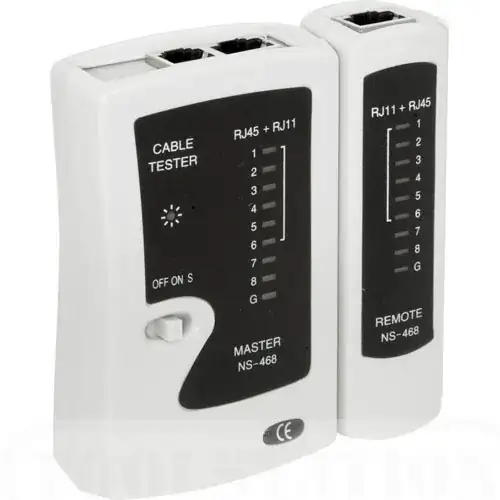

RJ45 Network cable used for 10/100Base Networks.
This is very time consuming because RJ45 have several strands of cable so testing one after the other can be beach. But one clever solution is to make a loopback on point B and test the corresponding points on PointA. If it does not loop back then the cable is most likely broken.
There are also network testing equipment that do the same as mentioned above.. but you have nice flashy lights and a nice loopback box supplied.Ebay a few bucks each for el cheapo ones.

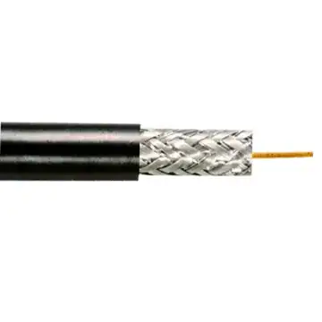

COAX
Coax is a funny one and depends on what you need it for. Coax for TV, satellite or CCTV again. On digital signals you might get choppy or images cutting in and out if there interference. On analog you will see allot of "snow" or shadows. It is best to replace or check the fittings to see that the connections are good.
But you can test the cable also ...
  1. Center to shield (No Ohm reading - No beep)
  2. Center to Center (Short/Continuity - Beep)
  3. Shield to Shield (Short/Continuity - Beep)
An extra step here (1) is to test for short circuit between single(centre) and (shield) without and return cable or joining any end. This will check if there is a short circuit on the coax.Possibly a nail or screw when right through the cable.
The other part if its used for a network then it all has to be connected and terminated to test it(but its unlikely its used for network because these types or network have been eradicated because of unreliability)
