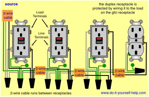

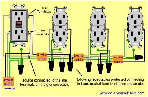

Let's start with an explanation of you kitchen circuits. Pretty much all kitchen circuits are GFCI protected. This is accomplished by installing either a GFCI breaker in the panel or the most common method is to install one GFCI outlet per at the beginning of the circuit and feeding through it to the other receptacles in the circuit. So one GFCI receptacle protects other downstream receptacles. I believe this is you configuration. Note that the other receptacles should be labeled "GFCI Protected", but this may not have happened or someone has taken the labels off.
After turning the power off to the GFCI receptacle you can take it from the box and if you look on the back side you will see that there is an input marked "Line" and an output marked "Load". The easiest way to fix you problem is to move the load side conductors and attach them to the line side the go through your entire circuit and install a GFCI at each receptacle location. That way you will not trip out an entire circuit just the one that is giving you trouble. This way it is easier to identify which receptacle is giving you problems, making it easier for you to correct.
Here are a few diagrams to help you understand.
This is what you configuration looks like now.
This is what you can do to fix your problem.
Good luck and stay safe.
