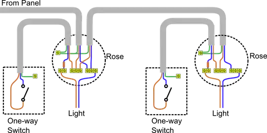

A typical UK Light circuit is wired like this
wiring diagram
Note that the blue wire in the switch location is not supplying neutral, it is a "switched live" that takes power from the switch to the light bulb.
Older homes will use a different wiring arrangement where connections are made in junction boxes in the ceiling and not in the ceiling rose instead. They still mostly use "switch loops" where there is no neutral in the switch location.
Some homes will use older wiring colours (black instead of blue, red instead of brown, plain green instead of green/yellow striped)
The fixed cable in wall and ceiling is called "twin and earth" or T&E and typically has a bare copper earth wire that you have to add a green/yellow sleeve to when installing switches, lights etc.
Most UK lighting circuits use 1mm² or 1.5mm² solid wires. The flex to the pendant lamp is typically 0.75mm² stranded wires (BS EN 60598) which can carry the 6A the lighting circuit breaker is rated for.
All connections are typically made using built-in screw-terminals that are part of the switch or rose etc. These are always recessed inside an insulating housing so that conductive parts cannot be touched.
For a switch loop, the most correct type of T&E is one with two brown-insulated wires instead of the usual brown and blue. However in most cases electricians use the normal brown and blue T&E and just put brown tape around the blue to indicate that it is not being used as neutral.
As you can see there is no neutral supply to the switch location - even if there is a blue wire present.
