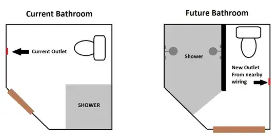

First of all, if this is a duplicate question please point me in the right direction as I couldn't find one with my specific situation.
I am relocating a bathroom shower to the opposite side of the room. There is a single receptacle on one of the walls that will be the new shower location. I want to remove this. From another question, I would just need to cap off the wires and put a blank coverplate over the box . However, I can't do that as it would be in the shower.
How can I properly remove this receptacle? Can I flip the current receptacle so it is on the opposite side of the wall that it is currently on? There is a bedroom on the other side of the current receptacle's wall.
