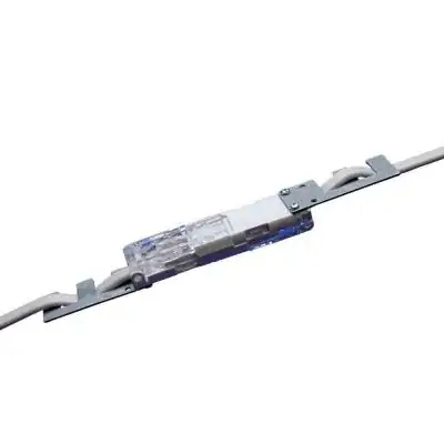

Devices exist that claim to be able to splice nonmetallic sheathed cables together outside of a box, and in concealed locations. Are these types of devices allowed by National Electrical Code?
Here's one example device.
Tyco Electronics Romex® Splice Kit

The use of these devices is limited to specific situations, which are described in 334.40(B) of the National Electrical Code. The 2011 version of the code had this to say.
National Electrical Code 2011
334.40(B) Devices of Insulating Materials. Switch, outlet, and tap devices of insulating material shall be permitted to be used without boxes in exposed cable wiring and for rewiring in existing buildings where the cable is concealed and fished...
Which means the devices could be used in exposed locations, and concealed in existing buildings, but only when fished. Adding the "fished" requirement, meant that the device would not be fastened in place. This would allow for the extraction of the device, for inspection, maintenance, and repair.

334.40(B) Devices of Insulating Materials. Self-contained switches, self-contained receptacles and nonmetallic-sheathed cable interconnector devices of insulating material that are listed shall be permitted to be used without boxes in exposed cable wiring and for repair wiring in existing buildings where the cable is concealed....
Now the devices can still be used where exposed, but the concealed use has changed. The device can be concealed, but only when used in existing buildings for "repair wiring". Which means that they should only be used where a cable was damaged, and replacing the cable is not practicable.
