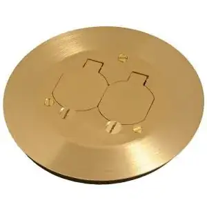

As far as the alternative of a floor outlet - that can easily solve most of these issues. However, a floor outlet will be too far away for modern kitchen appliances that typically have (based on modern kitchen electrical code) ~ 2 - 3 ft. cords. A hanging pendant (of the right type) does not have that problem.

Another option might be a flush mounted floor outlet:
floor outlet
