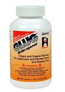

Here are some products that I have used for years and would recommend before spending a lot of money with a plumber.
Glug drain cleaner is a non-acid formula that works really well when you first experience a sluggish drain.
Glug Drain Opener
