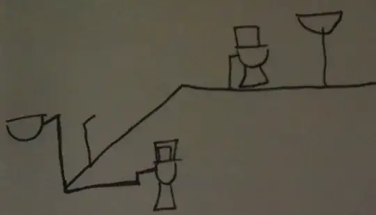

Big freeze, new house. Just found out the add-on bathroom was plumbed by amateurs, and the cold water supply froze. I don't have access to the frozen section of pipe (without major demo), so I can't heat the pipe directly.

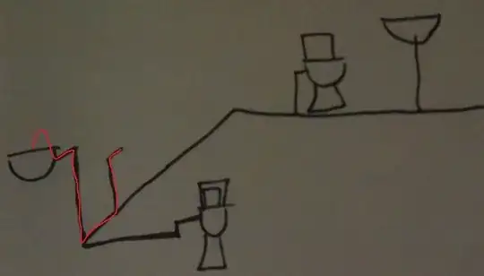

If I open the hot and cold tap on the sink faucet at the same time, while also opening the cold tap on the tub in an adjacent bathroom (which is also affected by the frozen pipe). The hot water backflows through the diverter of the faucet, and comes out in the tub. I'm using this backflow technique to try and heat the pipe enough to hopefully, break up the ice in the pipe.
All this got me wondering. If I have a plumber come out, is there anything they can do? Do they have a special tool or technique to deal with this situation? Would the plumber simply want to start cutting holes in the walls/ceiling to gain access to the pipe?
More info:

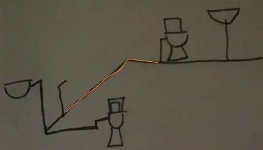

The water supply for the second bathroom seems to be tapped off the tub supply lines of the original bathroom. In the original bathroom the sink and toilet work, but the cold supply for the tub does not. This means that the frozen section of pipe is after the sink in the original bathroom, but before the tub in the same bathroom.
Rough sketch of cold water plumbing
Rough sketch of cold water plumbing highlighting suspected frozen section
Rough sketch of cold water plumbing showing hot water backflow path

If it's a metal/copper pipe, you could wrap the exposed portion of the pipe in heat tape to help speed the thaw. Since metal and water are good conductors of heat, the heat from the tape will spread fairly quickly down the pipe.
Or even just use a hair dryer. Not as efficient or quick, but still helpful.
longneck
  • 21,448
  • 52
If it's a metal pipe, call a weldor. Pipe thawing is a normal use of large portable welding rigs. You put a clamp on either side of the frozen spot and run current through it until it thaws enough for water to flow - the flowing water will remove the rest of the ice. Edit: Hmm - evidently this is less common than it used to be due to idiots and lawyers, but there may be "pipe thawing machines" that are more idiot-proof. I know we used to call the weldor to thaw our well-water pipe before we replaced it with a more deeply buried plastic pipe, 40 years ago. But he wasn't an idiot, so nothing caught on fire and he didn't ruin his welder.
If plastic, you're going to need to supply heat, or wait for it to thaw. If you run the water nearest the issue it will conduct a bit of heat into the pipes. If you can point a heater into a crawlspace it may also help.
What you are doing with the hot water flowing to the tub is a good idea on this line. Edit: it will also help heat the space where the cold water pipe is frozen, assuming the two run together through the walls.
You could attempt to raise the temperature in the room high enough to thaw out the pipe. Grab a couple of space heaters and close up the vents and under the doorways.
You could also rent a couple of torpedo heaters from your local tool rental, and try and heat the wall from the outside (I would not do this if you have vinyl siding or another material that will not stand up to direct heating).
Disclaimer: You will of course have to follow the proper safety precautions for using heating equipment in/around the house. Do not leave them unattended, remove all flammable materials nearby, be aware of ventilation concerns, etc.
