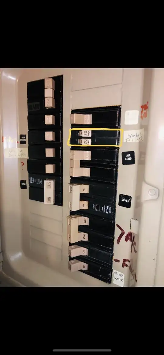

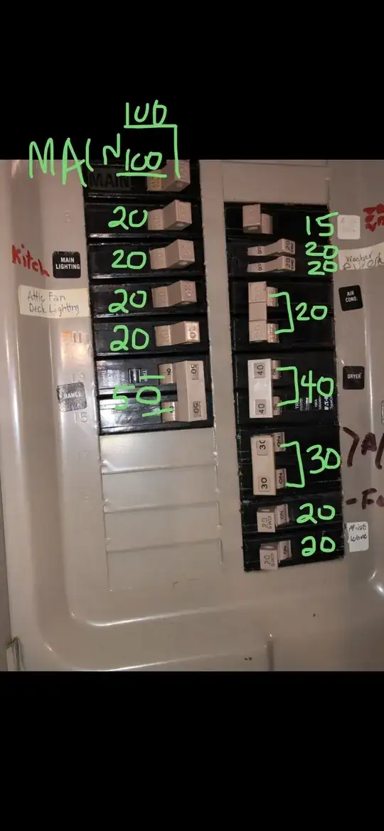

Edit: Is this panel overloaded? I'm counting 130 on left and 165 on right. Shouldn't it be below 200 total?

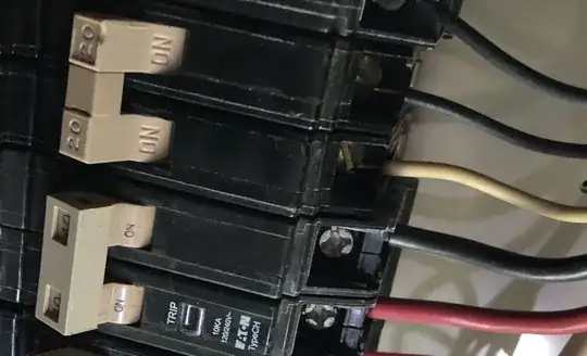

Edit2: The washer was wired with 12 gauge, so I moved the 14 gauge wire to the new 15amp breaker.
The number of spots open waa actually only the bottom 4 on the left. The top two were where the main power came in.
For newbies like me, the Cuttler-Hammer boxes were bought by Eaton, so I bought a breaker by Eaton labeled CH for under $9.

I'd add a new 12AWG homerun from the panel to the junction box
What I'd do here is put a new 12/2 homerun in from the existing 20A breaker on the circuit to the junction box where the 14 and 12AWG wires are split, then connect the wires in the junction box by size as well as color (12AWG black to 12AWG black, 12AWG white to 12AWG white, 14AWG black to 14AWG black, and 14AWG white to 14AWG white), save for the grounds which all connect together.
At that point, you can take the existing 14/2 homerun off the existing 20A breaker in the panel and land it on a new 15A breaker fitted in one of the open slots on the bottom left -- Eaton CH breakers are widely carried by big-box stores and supply houses across North America. (If you need to splice some extra 14AWG onto the end of the homerun to make it reach, go ahead and do so with a wirenut -- splicing in a panel is safe and Code-compliant, even though some ignorami misinterpret the Code that covers this to say otherwise.)
You can then fit a 20A GFCI to the 12AWG (20A) circuit to protect the dishwasher and receptacle.

On the breaker panel being oversubscribed, that's not actually a problem; they're supposed to be oversubscribed because not every load will be on at the same time.
As far as balancing the sides, actually sides work quite differently than you'd expect. This answer illustrates it. You have to count alternating rows, and count a 2-pole breaker as being in each row. That one in the upper right is not a 2-pole, but the linked answer discusses what it is. Both its breakers count as in the same row.
That is an excellent industrial grade panel, and I would keep it especially since you seem to have some spare space. The only problem I note is a 40A breaker allegedly for a dryer. Unless your dryer is very unusual, it should be a 30A breaker. In particular, dryer wires are usually 10 AWG, and 40A would overload them.

Panel capacity is not based just on the ratings of the breakers plugged into it, meaning that you don't simply add up the numbers on the handles. There is what's called a "diversity / demand factor" that is applied based on knowing that not everything it going to be running at full capacity all of the time. It's not an easy subject for the average DIYer, but it's highly unlikely that adding one more 20A branch is going to be a problem here. Think about it, you are not actually adding LOAD, you are spreading the same load out among more circuits.
But as mentioned, 14ga wire cannot have a 20A breaker protecting it.
