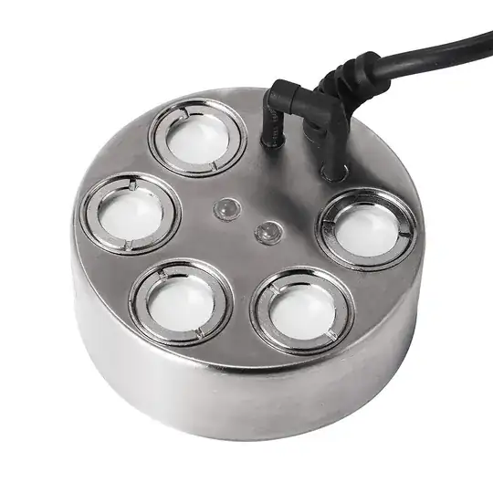

Second, more practical question: My apartment already struggles sometimes with keeping the unit warm, but it's also far too dry, so I need to humidify. I bought a mist maker with stated vaporizing capacity of 1600ml/h. Mist maker
It seems since I've had it running, the heater struggles even more than before. How do I convert from ml/h to BTUs I am losing to humidification? Do I need to provide other parameters (like a starting relative humidity and temperature)? I looked at Philip's chart at: http://www.truetex.com/psychrometric_chart.gif but I'm not really sure how to read it.
