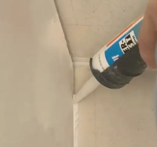

Apparently there are some caulks which are actually made for this specific purpose. I doubt any standard "painter's caulk" would work well, but this is worth bearing in mind if you are in a market where this is available.
The specific example I just saw was from Germany - the product "KNAUF Power Elast" which I spotted in a video. Presumably there are alternative similar products.
I don't read German but from a translation it seems like this material is meant to be particularly elastic which makes sense to avoid cracks. I can see where, if this worked well, it could be a lot easier than taping a corner (especially for a non-pro). It is also paintable.
There are some other interesting differences between the German practices for installing gypsum board and what I'm familiar with in the US. (No joint tape anywhere, for one thing, just mud).
When installing the caulk, these were my observations:
  • Used only for inside corners
  • Some type of watery joint prep (primer?) was painted on prior to caulking
  • Caulk was applied with a normal caulk gun & then finger tooled smooth
Anyway, no doubt the specific instance posed by the question was not good practice, but its good to be aware their might be valid alternatives in some places.
