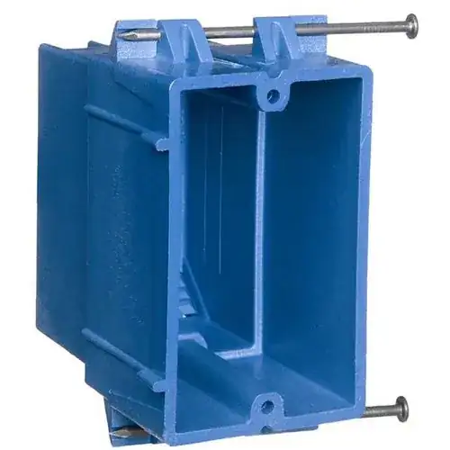

I will be running LV wiring in new construction. I've seen the open backed Carlon boxes, but have read that they are difficult to insulate, and therefore should not be used on exterior walls. I believe this is mainly due to the fact that spray foam can not be sprayed behind the boxes. However, I would think fiberglass insulation could still be placed behind them.
This is the quote from Structured Home Wiring:
Open back electrical boxes cannot be sealed to prevent cold air from coming in through the outlets
I am running 2 cat-6 and 1 coax to a single box.
Is there any real benefit to these boxes, over the 120V types (displayed below), especially if I don't plan on running conduit to the boxes?
