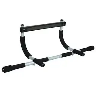

Both of your suggestions are the wrong kind of bar. Assuming the door has casing trim on it, you want one of these:
They're also like $30, instead of the unreasonable price of $150+ for a piece of pipe attached to two mounting brackets.
