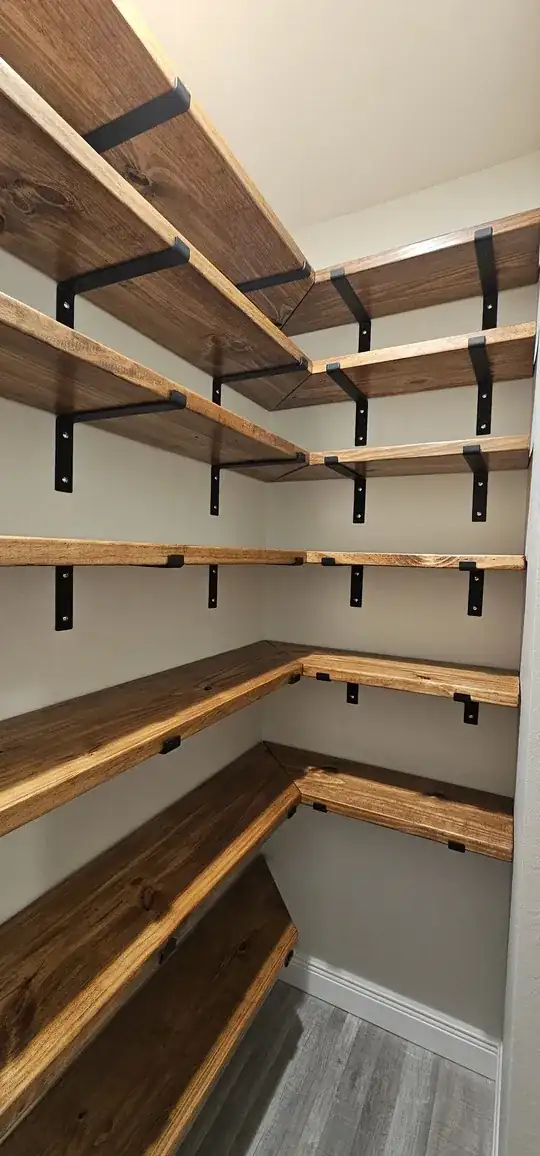

I used the toggle-style anchors with the long plastic guides attached - they're about $23 for a box of 25. They worked quite well while hanging seven 2" x 12" shelves (quite heavy) on our pantry wall. Two anchor points I targeted the metal studs in our walls and the third I had to just anchor into the sheetrock. You have to drill a 1/2" hole for the size that I chose, which is scary, but trust the process. It's key to not overtighten. Firm and secure, but no need for an impact driver or anything. Our shelves were filled with 30-40 pounds of stuff and probably weighed 20 lbs in just the wood. I wouldn't go climbing on them, but I have no worries about the integrity of the anchors. Here's a picture of the shelves just after hanging. Pantry Shelves
