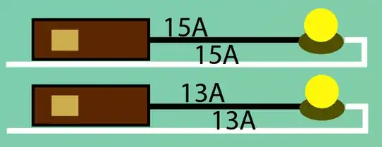

The current on neutral depends on good circuit design upstream of it. Here's what I mean.
You'll agree that this is a simple arrangement, where the circuit breaker on the hot serves to protect the neutral from overload.
Okay, that makes sense.
The neutral can't carry more than the hot, because the neutral only serves the one hot. As long as there isn't cross-hot leakage, there's no chance of overloading that neutral.

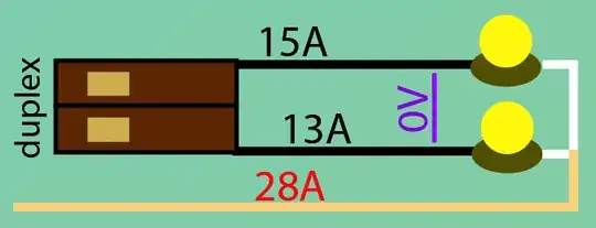

So what happens in a shared-neutral situation?
Can you spot the problem?
The neutral isn't any bigger than the hots, yet it's being asked to carry twice the load. There is no breaker on the neutral to protect it. So this sharing is setting the neutral on fire.

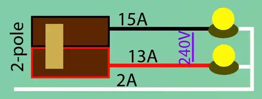

Take any two circuits. (They can either be on the same pole, or on different poles). We just discussed what happens if they're on the same pole. Look what happens if they're on opposite poles.
Now that makes sense.
When the red hot draws 13A, it's drawing all of it from the black hot. Most current goes through 1 lamp then the other, and back to the other hot. Only 2A actually travels down the neutral back to the panel. Neutral only carries the difference in currents.
You can try plugging in any value of amps on either leg (between 0 and 15). In every case, the amp flow on the neutral is always less than 15. So this configuration is safe for the neutral.
So there is method to the madness of shared-netural, and this is the method. But it only works if the 2 circuits are on opposite poles, and in fact, there are rules that absolutely require this. Notice the way I drew the 2-pole breaker with one big fat handle.

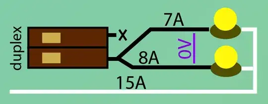

If you cannot fit full 2-pole, and cannot find appropriate quadplex, then splice both hots to each other with a pigtail, and attach the pigtail to a plain breaker. This will limit both half-circuits to 15A among them, but will assure the neutral isn't overloaded. This would be a way to do it without buying any breakers:
