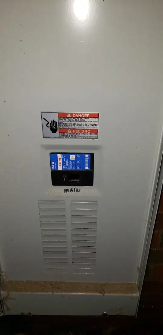

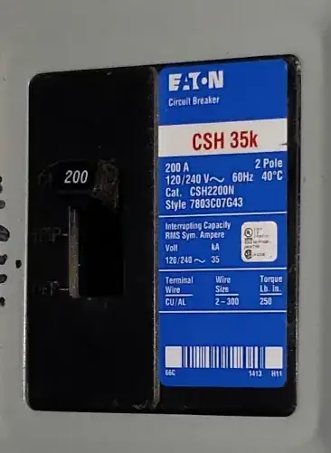

I know nothing about electrical code or wiring. I want to add a breaker to my main disconnect panel. Reason being it is super close to my garage compared to my panel inside my home. The main disconnect panel is a full size panel with a main switch at the top then spots for breakers below. Its located at the front corner of the home and I would simply need to run the service 10 feet. I believe it's a 200a service, installed by the previous owner in 2012 and passed inspection at that time. I would like to feed from this panel to my garage and possibly add a sub panel for some additional outlets and a 220v outlet for welding. Is it ok to do this or should I plan to budget to run from the main panel inside the home?

First, pictures are worth a thousand safety tips. Can you add some pictures of the existing panel(s)? Adding a run has it's challenges. The cable size, type, conduit type are all determined by length of run, amps, and location; might be 1 or 2 others I missed.

I believe you would be able to do what you're looking to do with relative ease. You can tell your service by the breaker size of your main panel. If the main throw is rated at 200A, it's safe to say you have a 200A service.

Not an electrician, but after reviewing your photos I would say go for it. Consider calling the power company to pull the meter when you hookup to the main panel. Or an electrician to discuss if code allows it. On the main, you can flip that switch and normally that will kill power to the lower section of your panel to safely install a breaker. The heavy wire coming into the panel will still be very hot, and plenty powerful enough to severely harm/kill you compared to just a 20 Amp circuit. However, use common sense and assume everything is hot. Carefully pull the front cover off after flipping the main, and examine the rail. You should have a place for breakers to snap in if it's designed to be done.
