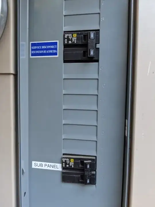

Next to my meter I have a square d all-in-one combination service entrance device with a service disconnect breaker and a sub panel breaker that must be going to my indoors panel, see attached images. I'd like to add a 15A or 20A breaker for an additional circuit close to the outdoors disconnect panel. Can I do it?

To answer your question, yes, there shouldn't be any reason you can't add a breaker to the outdoor combi box. Others here might chime in with local code issues, but I doubt it. If it makes you more comfortable, turn off the main breaker to shut off power to the buss. Remove the cover, clip the new breaker in place, twist out the cover for that space and wire up the outdoor circuit using conduit and THHN/THWN or UF (UF is hard to work with!), NM (Romex) isn't legal in outdoor installations, even if in conduit.

You know around this place, the top advice is "Get a really BIG panel". They did that and then some on the outside... that is a "16/24" panel, meaning it has 8 spaces (below the main) to accommodate standard breakers, and 8 more spaces (above) that will accommodate either standard breakers or "double-stuffs". You can tell this from the panel diagram in the labeling. Currently the bottom 2 spaces are being used for your house feed, and the rest of the panel is wide open.
Looks legit to me. I don't see any problem placing circuits out here.
Use Square D "HOMeline" breakers only. Do not use any other type. (NEC 110.3(B)). It's legal to use any space in the panel, except:
  • Don't get your hopes up on using double-stuffs much; most new circuits require AFCI or GFCI and those don't exist in double-stuff.
  • For aesthetic reasons, I'd suggest using the lowest available space. Most people stumbling onto an unfamiliar panel expect the main breaker on top, then a gap between main and other breakers. The usual "stranger user" is a First Responder (e.g. Fire Department).

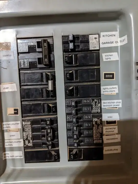

The indoor panel is another 16/24 (16 spaces with 8 spaces allowed for double-stuffs). Now that you know what to look for in the panel labeling, see a problem?
The spaces allowed for double-stuffs are on the bottom half. Yet, there's one in the upper right. Doesn't belong there.
That panel takes Murray (now Siemens) breakers, and they all look correct for the panel.
