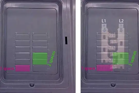

A service panel has a basic unit I call a space. That's apparent when you look at the "knockouts" on the cover.
Electrical power in North America delivers split-phase power. Meaning there are two "legs" or "poles" - L1 and L2 - both 120V from neutral, and opposite-phased so they add up to 240V.
Pic: X-ray of service panel showing bus-bars alternating rows
Here's an X-ray of a service panel cover. See the trick? The buses are arranged in alternating rows. Every other row is a different pole on both sides. Any single-space breaker gets only one pole and 120V (its circuit also attaches to the neutral bar, not shown) -- but a 2-space breaker has access to both poles and 240V.
A single-space breaker cannot get 240V. That's very important when we get to duplex breakers. Now let's fit some breakers.

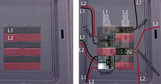

Pic: striped for legs with breakers in
On the upper right you see a single breaker. This occupies one space and serves one circuit.
On the upper left, you see a 2-pole breaker: this occupies two spaces, and can access both poles L1 and L2. Both sides will trip together if either side overloads. This is used for 240V loads, or for multi-wire branch circuits (MWBC).

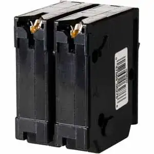

Backside of a 2-pole or quad breaker. Note the 2 clips grabbing 2 different poles.
Duplex and friend
On the lower right is the star of the show: the duplex/tandem breaker. This occupies a single space and can only access a single pole. The sides will not trip together. It cannot power 240V loads, it must not power MWBCs, and it is generally used for two unrelated circuits. The entire point of the duplex is to save space in the box. We often call that a "double-stuff" for obvious reasons, and to emphasize how it's different from a 2-pole.

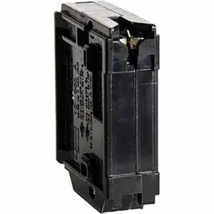

Back of a duplex breaker. Only one clip to grab one pole.
Lower left is the quad breaker, a 2-pole duplex breaker. Again the purpose is to save space. It's just what it looks like, 2 duplexes, except it can access both poles L1 and L2, and it has handle-ties so the inner pair will trip together on overload. That makes it suitable for a 240V load or MWBC. On this model, the outside pair is also tied together with common trip and can serve 240V loads or MWBC. Or, you can get these breakers with outer breakers independent.
