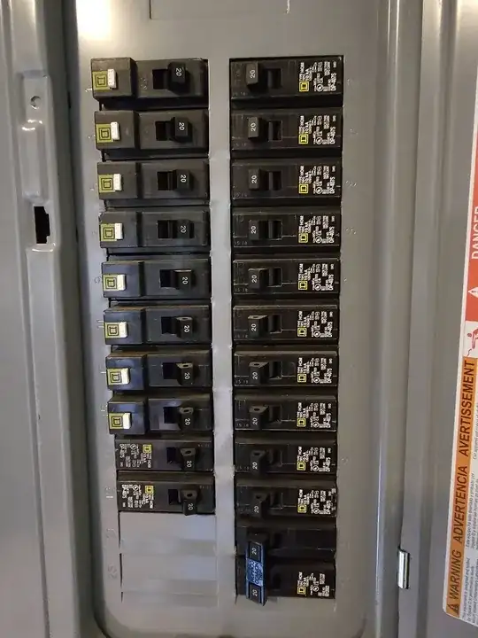

hot tub pabelsub panel in house labelsSub Panel in house for lights and receptaclsI recently built a 30x50 shop with a small living area built out inside of it. Now I need to feed power to it. I have a main 200amp feed through panel just below the meter. It's a Siemens PW0816B1200TC. Right now that panel is pretty full, see picture attached. I could remove the 2- 20 amp breakers on the left as those feed receptacles right next to the panel. Ideally I'd like 150amp service running to the shop which is 100' away. For that I'll run 2/0 aluminum cables. Can anyone guide me through how I can get this done. main panel below meter

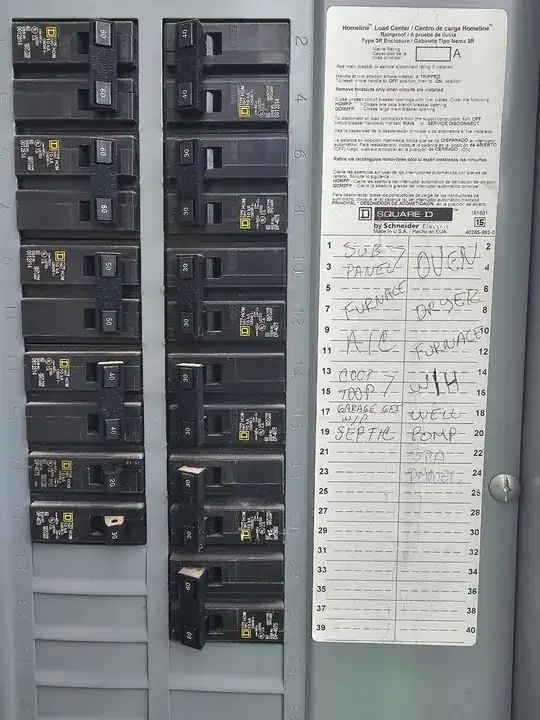

Here's the panel outside of attached on house. There's another sub panel in the house that has all the receptacles and lights on it. That gets supplied by the 60amp breaker on the top left. Sub Panel attached to garage

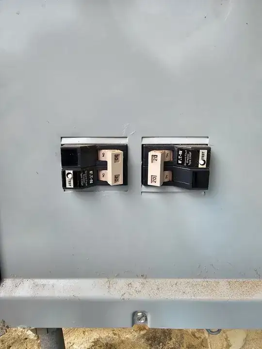

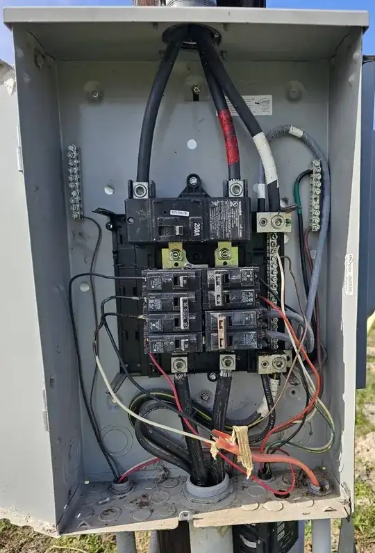

The question is "how do you get more breaker spaces in the outdoor trailer/ranch panel?" And the answer is have the surge suppressor and 30A load share the 30A breaker. Surge suppressors are not loads and do not need dedicated breakers. If the Siemens breaker is marked for 2 wires per terminal, there ya go, otherwise pigtail off a #6 pigtail. (#6 just to stop people from whining about restricted current path to a surge, if that's not you, #10). If even that is intolerable, get a Siemens 30/50 quadplex such as Q23050CT2 so you can direct wire to the breaker. This "trailer/ranch panel" is an 8/16 and can accommodate all double-stuff breakers, however none exceed 50A.
I don't know the stab limits for a Siemens panel but if you don't know, 125A is a safe assumption. Be careful what you put across from the 100A breaker. The well pump is 1HP so nowhere near 25A. The surge is 0A. So those are perfect. The 20A singles could go across from the 100A also.
Or you could move the surge suppressor to the 40-space panel. You've placed it as close as possible to the utility on the logic that "the outside utility is the only source of surges and that none of my appliances generate surges!" I would place it in the 40-space panel to more directly suppress locally generated surges (looking at you, air conditioner). As regards outside surges, the extra attenuation down the cable run from trailer/ranch panel to 40-space will make it easier for the surge suppressor and wear it down less.
This house looks bonkers overloaded

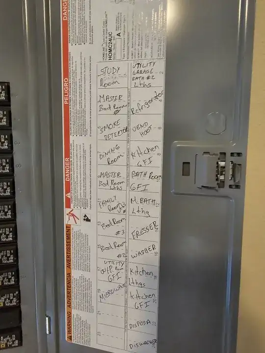

I see a normal house panel in that Square D 24-space... OK... looks like wild guess 70A to me give or take. Okay.
But then, I see another 40-space panel with no less than ten 240V breakers. We've got 60A to the above subpanel (that doesn't help your Load Calculation any). TWO "furnace" breakers totaling 90A. A 50A A/C breaker. A 50A spa panel. 40A "COOP TOOP" whatever that is. On top of all the normal loads + a well pump. This house does not have gas, does it?
This is way more stuff than you can get on a 200A panel, unless some EMS is happening off screen.
Looking back at the work done in the trailer/ranch panel, I suspect this house has enjoyed many upgrades since the last time an inspector saw it.
  • I see a 30A circuit wired with orange NM-B cable (which is not allowed outside).
  • I see 200A utility merging with 100A? 130A? of solar to total 300A on that bus going onto the 200A rated bottom lugs and 4/0 feeder to the 200A bussed Square D 40-space. So 300A could show up on the bus of the 40-space. Does it have a main breaker? It really needs one to prevent that from happening.
  • And now you want to add 150A more load onto the outdoor Trailer/Ranch Panel. The 120% rule is not enough, and it doesn't even work on this panel, because the loads (note thru lugs) are not between main and solar breaker.

The 50 amp breaker appears to be attached to a TVSS right below panel. There are 2 types of these devices. One requires to be connected to a breaker, and type 2 can be connected directly to bussing lugs. If so, do so. Remove the 20's. Now double check the breaker loads in the garage sub panel. "Big 2 poles" is not enough info. How big. AND connected to what? This panel only allows 110A per stab. If you can replace the 100A for garage with an 80A, place the 30A across from it, and the you have a perfectly legal, code compliant space for a2 pole 100A breaker for new shop.
Even better that 100 is a solar feed. That let's you use your original idea. Pull the two 20A out and you can throw up to a 110A breaker in for shop. Just have it across from anything except the 30A.

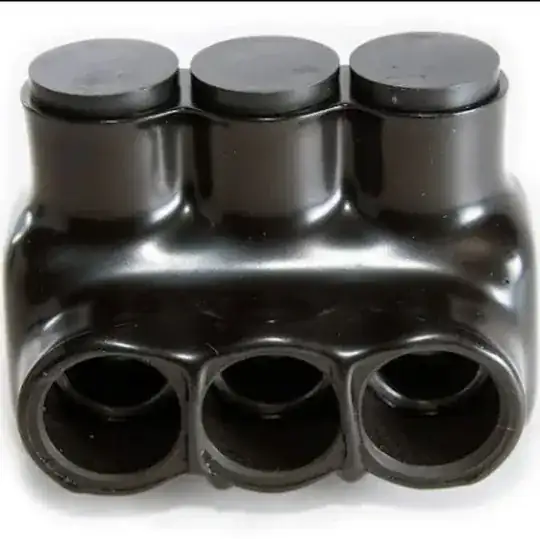

Also, if you do need more than the 100A, you can use wire rated for 200A and splice into the sub panel feeders. Polaris and NSI make awesome insulated lugs which will work well. Polaris lug
