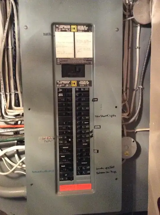

The main panel is 220, so relatively new. The kitchen is 20’x15’. It only has 6 outlets, one light and one oven outlet. I plan on putting in an island with multiple outlets, pot lights and the number of required outlets to meet code. I will also be relocating the location of the oven, so that will need rerouting. I have two slots open and would expect to have at least another when the existing one for the kitchen would be replaced with the new panel.

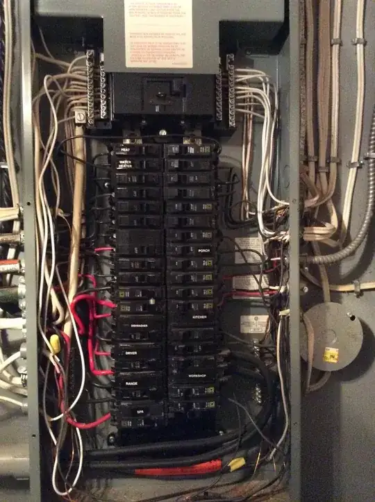

You should have no issue adding a subpanel to this panel
Your existing panel is a Square-D QO (and a rather large one as well, at 42 spaces). This panel type is still made to this day, with relatively few design changes, so you will have no trouble finding the correct feeder breaker (a QO2125 with a LK125AN for the neutral and a LK70AN for the ground) to install here (there are two free spaces on the right side of your existing panel, just above the orange tape, which should be replaced with the correct QO filler plates or dummy breakers while you are at it). I would then run 1/0-1/0-1/0-2 Al SER from this existing panel to the new panel location, which is a sufficient cable for a full 125A feeder to your new panel.
If you wish to go larger, you can do that by moving the bottom rightmost breaker to the left side, and fitting a QO2200 breaker in the bottom right position, along with a LK225AN neutral lug and a LK125AN ground lug. This leaves you with only one space to occupy with a filler plate or dummy breaker as the QO2200 takes up four adjacent spaces in your panel, and means you can run a 4/0-4/0-4/0-2/0 Al SER cable, which gives you the full 200A your service can provide at your new panel location.
With this, due to the fact your existing 42-space panel is almost full already (!), I would install a 40-space, 200A, main lug subpanel as a minimum here; if you wish to stick with QO, this would be a OQ140L200PGC. If you're willing to spend an extra $50-$70 on this project, you can get a 54-space, 225A, main lug panel instead, namely the OQ154L225PGC. These panels both come with factory-fitted ground bars; just make sure there is no green bonding screw fitted to the new subpanel, keep the grounds on the ground bar and the neutrals on the neutral bar, and you're good to go with respect to grounding.

How old is your main panel? If old panel is full, think about replacing it with a larger one. If you have room to add a feeder cable to a sub panel, you have room to add circuits from a new main panel to the kitchen.
Now that you've added the main panel information and it's in great shape load and manufacturer wise, the sub panel is definitely the way to go. Harper and ThreePhase have added all there is to add so good luck and stay safe out there.
