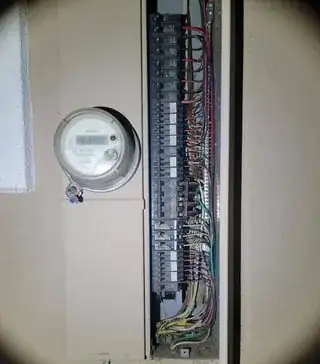

I recently got a Tesla and want to install a wall-mount charger. It needs a 60A double pole circuit breaker for max charge speed so I am wondering what I can do here to free up that space. I have a single pole space at the bottom.
Someone suggested I can swap the top 2 2-pole 30A breakers with 1 Quad BR 2-30A Pole like this and that frees up the needed space. I am open to any suggestions.

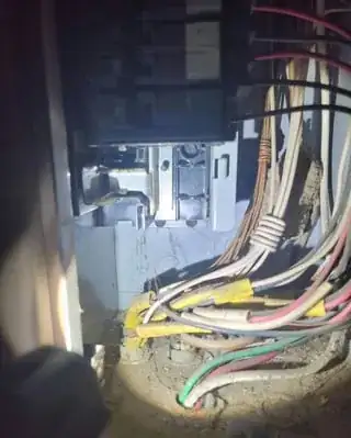

You have a Murray panel. The only correct breakers for that panel are Murray MP or Siemens QP (which is simply a rename of MP). Alien breakers can damage the panel. Now I gather the A/C contractor put that Cutler Hammer BR250 breaker in there? That should be changed to a Siemens Q250.
Further, I note that both of the 30A breakers have red-black wires - no white wire on the breaker, so clearly these circuits have neutral. Since they do, they need a common trip breaker (one side overloads, both trip). That Eaton BQ was not one, by the way.
Now looking at the panel label it appears every breaker is permitted to have tandem breakers. You certainly could compress the two 30A/240V breakers into a Siemens Q23030CT2, a quad with common trip both inner and outer.
While you're installing quadplex breakers, I call your attention to all the single breakers with red wires on them. These are called Multi-Wire Branch Circuits and they are wired dangerously wrong. MWBCs must be phased so there is 240V across the two hot wires in the same cable! Further, there MUST be handle-ties across the two handle throws. So you will need to read up on MWBCs, follow the hot wires to identify your MWBCs, and install quadplex breakers appropriately. However, if the MWBCs don't have 240V loads on them, they don't need common-trip breakers. Depending on what Siemens offers, it may also be possible to do it with handle-ties.
A close examination of the diagram on the door indicates the top 6 stabs are designed for single circuit use only. So no, replacing 2 of those breakers is probably out of the question.
Also note despite the careful grouping of wires in the panel, the installer didn't provide any slack that would allow you to reposition circuit breakers.
Thirdly, any new work in here should be subject to inspection, and there are a large number of handle ties (#ECQTH2) missing in this panel.
To free up space, you should figure out which circuit would be easiest to move to a new subpanel and then use the new space for the feeder. I suggest the top-most circuit because it feeds from the bottom and has the most slack available to reach a new panel.
If you're desperate to avoid adding a panel, there is another option available by replacing the AFCI breakers with the updated tandem AFCI model (#Q2020AFCP). That would free up one space and allow some shuffling of the bottom 7 breakers. Just keep in mind this would require work on the neutral bar right next to the main breaker, which is live equipment labeled "WARNING", so always wear gloves and safety glasses.
