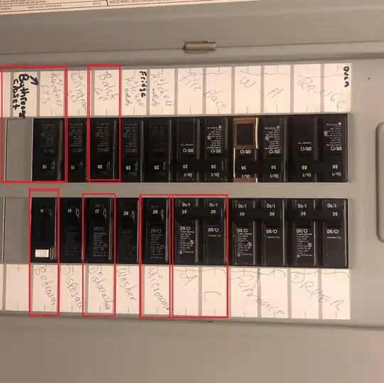

Half of the Condo I rent is losing power sporadically, sometimes for minutes other times for hours. We have power loss to our kitchen lights, microwave, outlet above dishwasher, the dishwasher, entire bedroom, both bathrooms, and the AC unit. Living room lights and outlets, fridge, oven, & foyer light work fine and never go out. We also have occasional flickering lights in the rooms with the power loss. I would say its the breaker, however the issue isn't just on one side of the breaker, its completely random. Also, when the power goes out we are using minimal electricity (usually just a light or two) so we are definitely not overloading the system. It's also important to note that the breaker NEVER trips and we just have to wait until the power just "magically" comes back on. Any thought? 2 electricians have been in and cannot find the issue yet, thank youenter image description here

You have lost one phase or leg (terms vary) of your power. 120/240 power comes in on 3 wires - two hots each 120V from the neutral and 240V from each other. Most breaker panels are designed with alternating legs. Left & right in each row are on the same leg. 240V (dryer, oven, A/C, etc.) use a pair of breakers, one on each leg.
Your electrician should have been able to figure this out. In any case, CALL YOUR ELECTRIC UTILITY and tell them you have an intermittent phase/leg out. They'll check it out for free and fix it if it is on their side, which is very often the case.

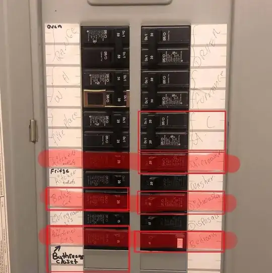

It's not random -- you've lost a phase.
Every other breaker in your panel is on opposite phases of 120V, and 240V breakers grab both. The pattern you are showing means that one of those phases is working fine, and the other one is intermittently dead. See the images in Harper's answer here if you want all the details: What is a tandem breaker (aka duplex, cheater, twin, double-stuff, etc.)?
Very often, the problem is on the utility's side, and they'll come out and check it for free. There's also a possibility that the wire is coming loose on one of your panel's main lugs, but I assume your electrician would have caught this.
Note that in the meantime, you should either shut off your main breaker, and/or shut off all 240V breakers -- since the 240V breakers grab both phases, they can backfeed the dead phase with weird voltages (effectively your 240V loads are now in series with half of your 120V loads), which may damage your devices.

I have a hunch that the following circuits are dead.
The reason I guess this, is how panels work with the two 120V power buses giving 240V. Check out my diagrams on that and a light bulb may go off in your head! Probably not in your kitchen though.
I'm betting the ones you haven't marked are simply ones you haven't had occasion to use, yet. Since you care about A/C, obviously furnace and fireplace aren't on your radar.
Noting that the top 6 breakers (12 spaces) are all 2-pole breakers. It's possible the 2-pole devices have some small amount of performance due to current leaking through the dead 120V devices. Similarly, the dead 120V circuits will somewhat light up due to the low impedance in the large 240V appliances bringing power over from the other leg.
This is a classic "lost pole".
The described pattern is one pole of your AC power, because of how panels work. So I think you have lost it, probably out at the pole, possibly in meter wiring.
Call the power company and report an outage. They should be out in an hour or two and take care of whatever the problem is at the pole.
The good news is, this is something you are allowed to do as a tenant.
If your condo comes off a central transformer with distribution handled by the condo association, then the problem is probably in their bailiwick. Who do you pay your electricity bill to? That is the question.
Don't contact any more electricians until the PoCo swears it isn't them.

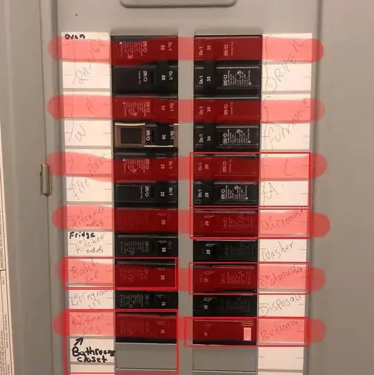

Another theory: mangled panel bus.
If the "red" bus had a serious meltdown right there at the 5th row, it would clobber everything below it. The fireplace being opposite the A/C, maybe you just haven't tested the fireplace.
But this is something an electrician should notice immediately after removing breakers in rows 5-8. There should be visible carnage.
There's a remote possibility: a hacked Rule of Six panel melting down
After all, if we presume that your search was systematic, your outage looks more like this:
And that looks like a classical "Rule of Six" panel. This type avoided having a an expensive >60A main breaker by having 6 large "main breakers" in the top 12 spaces of the panel. The rest of the panel (lower area aka lighting circuits) was fed by one of those breakers, typically in the lower right (where you are having a problem).
My theory is someone "hacked" this Rule of Six panel to feed the lower area without using that lower right breaker, freeing it up for use as a general breaker. Something went wrong with the hack, breaking one leg of the lower area and the breaker in that spot.
However, against that theory is the fact that I see hints of a space for a main breaker. Rule of Six panels did not have main breakers; that was the whole point.
