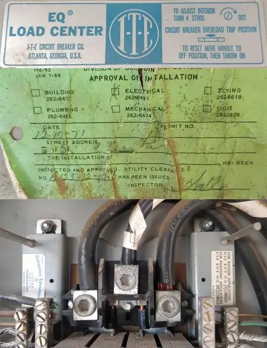

I have a house built in 1971 (EQ Load Center - 200 amp service panel) that is all aluminum wiring and I remodeling the kitchen. The existing wiring is technically working but questionable. We have lived in it for 2 years without issues. I have had a couple of electricians over and they said it works, don't touch it if you don't have to but I suspect they are not looking too hard.
I am remodeling and upgrading room by room. My goal is to pigtail all the aluminum to copper with nolox so I can use newer style receptacles and switches. I need and want to replace any aluminum wires with copper when I can from the home run of aluminum.

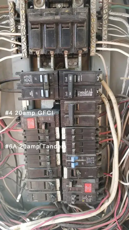

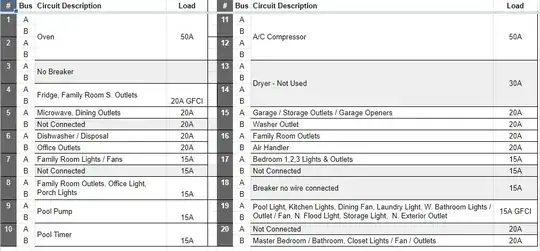

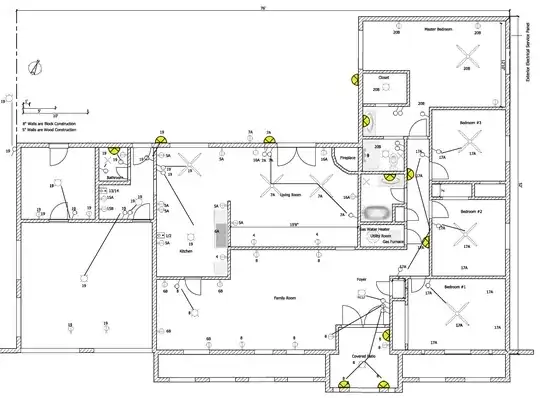

During my kitchen remodel I found that I have 2 - 10/3 aluminum wires that are split on 2 different circuits. My main panel has a few tandem breakers. In this case I have one 10/3 wire that the red / hot is for circuit #6A - [20amp tandem breaker - (Dishwasher and Garbage Disposal], and the black / hot is for circuit #4 - [20 amp single breaker (Kitchen Receptacles)].
My second line is similar (10/3 aluminum split out to 2 different tandem breakers) #5A - [20amp tandem breaker - (Kitchen receptacles)] #6B - [20amp tandem breaker - (Office receptacles)]

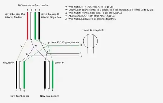

With this information what is the correct way to take the 10/3 aluminum and create 2 different circuits still? Please review the diagram as I posted what I think is the correct approach. Thanks for taking the time to make comments / answers. I really don't want to run new wiring as this house has been using this wiring for so long there must be a correct / safe way to do this.

The red alert here isn't actually the aluminum wire. It's the multi-wire branch circuits particularly when combined with double-stuff breakers, with that stacked on top of a 1970 era panel.
Aside from the usual horror-shows like Zinsco, FPE, Challenger (that one's fixable) etc., there's also the inherent fact that 1970s era panels are much too small. That tends to trigger the use of double-stuff breakers, and that introduces a catastrophic failure mode with multi-wire branch circuits.
A multi-wire branch circuit is the thing where you have a /3 cable and split the hots and share the neutral. You seem to have a good grasp of the basics, however your breakering is wrong and unsafe.
You must wire the feed breakers correctly
This applies regardless of copper or aluminum.
We're going to hit the first rule of multi-wire branch circuits: They must be fed by a 2-pole 240V breaker which is handle-tied and has common maintenance shutoff. We strongly advise full-size (normal) 2-pole breakers that take 2 full spaces, because they prevent a common mistake, and they have the option to be AFCI or GFCI.
However if you have to settle for a quadplex breaker, you can attach the MWBC to the two inner terminals with fair confidence, because those are always handle-tied. While they do make quadplex with the outer handles also tied, you have to be careful and make sure they really have common maintenance shutoff. Try it in the shop; if you can shutoff one outer switch while holding the other one on, you can't use it. For MWBCs, don't worry about common trip; you don't need that ability. Even so, hook up outer quadplexes carefully: The first circuit must go on both inners, the second on both outers, like
 R2 - R1 -- B1 - B2
         or
 R2 - B1 -- R1 - B2 (however this can be confused with a dangerous one!)
DO not cross them like this, or you'll defeat common maintenance shutoff (although at least the phasing will be right):
 R2 - R1 -- B2 - B1
Heh heh, see what I mean? Because this is so confusing (especially for "the next guy" who will have no idea what he's looking at), I entirely disrecommend outer terminals on quadplexes.
Aside from assuring the whole circuit is de-energized for maintenance, the much more valuable aspect is that the handle-ties assure the two hots are on opposite poles, as they need to be. (otherwise the neutral can overload - this is the biggest danger in MWBCs).
So far, one of your MWBCs is wired the dangerous way, and I suspect you got away with it because one leg goes to the garbage disposal. Either you don't run garbage disposal and countertop heat appliances at the same time, or your overloads were very short duration, not long enough for the wires to heat up. Congratulations on your luck; don't push it.

Your drawing calls for using wire nuts to splice aluminum. Nope. The only thing I can possibly recommend is Alumiconns, which are true lug connectors of the kind which have proven reliable with aluminum wiring, just miniature versions of them. Alumiconns are designed from scratch to be aluminum splices, not copper splices tweaked, which is what caused the problem in the first place remember. Yes, I know they sell purple wire-nuts, but they are the "backstabs" of aluminum wiring.
I recommend using 2-void Alumiconns with a copper pigtail in all cases. Including ground! That will make it easier for you or the next guy to add additional wires or outlets here. In some cases that will add an extra splice, but a copper wire-nut splice is no problem if it is competent. Competent means you crank it down hard, and give it a "pull test" holding the nut and trying to yank each wire out. If any fail the test, iterate on your technique.

The first, and foremost, concern is that your MWBC doesn't follow the rules needed for a MWBC, and in fact won't work, even, as the shared neutral will cause imbalanced current into the GFCI in space 4, tripping it. You can fix all the issues with this MWBC in a single stroke by getting a QF220A and putting it in spaces 3 and 4, then landing the wires currently going to 4 and 6A on the QF220A's hots, and the shared neutral on the QF220A's load neutral, with the line neutral pigtail landing on the neutral bar. While you're at it, take stock of the rest of the wiring in this panel and make sure that the MWBCs are landed correctly (i.e. with their hots on opposite legs), with two-pole or quadruplex breakers or handle ties used where needed to ensure that all MWBCs have common maintenance shutoffs. You'll need to use your torque screwdriver to tighten the lug screws to the manufacturer's specified torque when making these connections up, by the way, in order to conform with NEC 110.14(D).
Who let the aliens in?
Your panel is a Siemens EQ, which requires Siemens breakers. However, the two GFCIs (spaces 4 and 19) are GE THQLs, some of the other branch breakers (1/2, 11/12, and 17) are Eaton BRs, and the tandem breaker in space 20 is a Square-D Homeline, none of which are listed for use in a Siemens panel. Replacing these alien breakers with the correct Siemens breakers (or UL classified Eaton CL breakers) will be needed to get this panel to meet Code.

In the junction box you described, there's work to do as well. While the existing Alumiconns at W and Y and the all-copper wirenut junction at X are proper, the aluminum-to-copper wirenut splices at V and Z need to be straightened out. In V's case, you can simply replace the wirenut with a two-port Alumiconn, making sure to use a torque screwdriver to torque the terminal screws on the Alumiconn to spec, while Z will require a two-port Alumiconn to a bare or green 12AWG copper pigtail, along with a new wirenut to join the copper ground wires to each other, the pigtail to the Alumiconn, and to the box ground. You may also need to put an extension ring on the box housing these splices due to practical reasons as Alumiconns are rather chunky creatures compared to wirenuts.

What you are describing is a multi wire branch circuit. You cannot use tandem breakers on a multiwire branch circuit. A double pole breaker or 2 handle tied breakers are required. Using tandem breakers on a multi wire branch circuit will overload the neutral and will create a fire hazard. As far as the wiring it looks correct once the breaker is changed to a double pole or 2 handle tied breakers.
