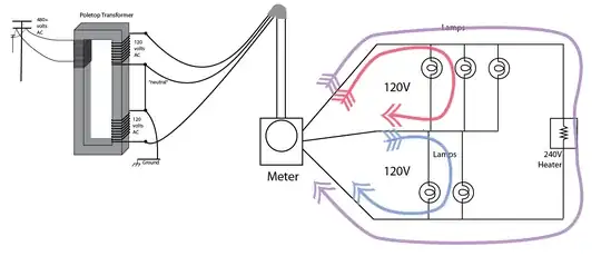

Hoping for some much needed help. The other day my lights flickered and half the power and outlets went out in my home. They have gone and off periodically since then, spontaneously shutting off at times with nothing “triggering” it. My electrician couldn’t find anything, but not sure how well he looked. I called my power company and they said all is well outside and at the meter. The areas I am losing power to are not on the same leg, the weird thing is, is that I can get the power to go back on by turning on a few faucets to hot water and getting my well pump to fire up. It seems like once the well kicks on, its restarts the power to everything.large breaker panel with breakers

Here's how your house normally works.

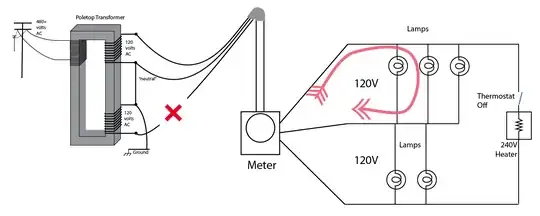

Here's what happens when a hot wire breaks.

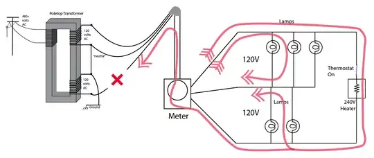

That's simple enough, right? Half the 120V loads croak. And all the 240V loads... right? But wait. What if they are both on? Say that water heater cycles on.
This. This is why the electrician and the power company read near-120V on both legs, declared victory and went home. At the time they checked it, the water heater or other 240V load happened to be cycled on. What they neglected to check was the voltage across the 2 hot legs, which should have read 240V but would have read perhaps 7 volts.
I bet they actually read 122 and 115V, and told you the difference was normal.
Next time they come out, switch all 240V and MWBC breakers off to stop that goofy flow pattern you see in the third diagram. Then, they'll be able to see the problem.
