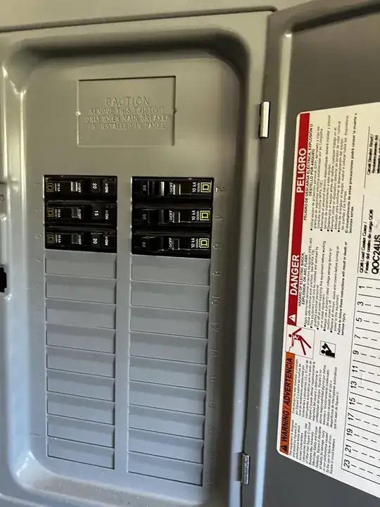

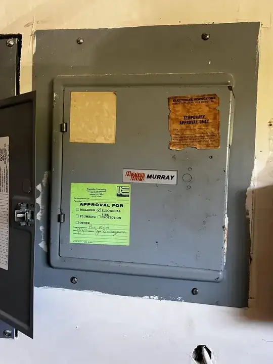

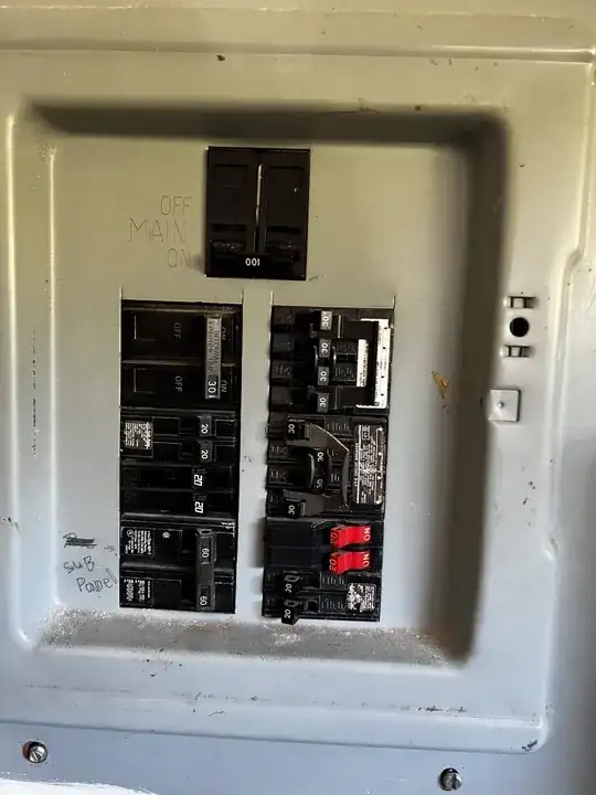

I'm considering purchasing a house and I took a look at the electrical panel. The house was built in 1979 and at some point they added a sub-panel. The breakers in the original panel look like a combination of different vintages, I can't tell if these are all the appropriate breakers. It is a Murray panel, and I recognize the MP-T style breaker in the lower right, but I have never seen the ones with the red handles. It looks like they used to have an electric stove and oven, but those are not currently in use. I would like to potentially put an inductive stove in. There is a sub-panel right next to it, that has plenty of space, but given that it is protected with a 60A breaker in the main panel, I don't think I can add more load there.
Any other red-flags about this panel?

Top left doesn't look like a Murray. It looks like a GE maybe -- and it's an A/C unit! Alien breakers are most common on A/C units because the contractors don't care and aren't electricians.
As far as "old breakers", I have to guess that you haven't priced these breakers. You could replace the whole kaboodle for under $100 total, so why wring hands? Just replace any you don't like.
On the Square D "QO" subpanel, that panel uses a completely unique bus design that nothing else can possibly fit in. So it it is impossible to use alien breakers. Every breaker which fits in a QO panel is approved for a QO panel. (note this includes Eaton CHQ and Siemens QD types, which are made exclusively for QO panels).
As far as the QO panel maxing out the 60A breaker, how did you get that? However you got that, it's wrong. The only correct way to ascertain that is to do a Load Calculation on the panel as described in NEC Article 220. The only way that five 20's and a 15 could possibly "max out" a 60A panel is if each circuit is "maxed out" (i.e. each 20A circuit has 16A of grow lights or Bitcoin miners that are running continuously all day all night). Other than that, the breaker handles don't enter into the Load Calculation very much; you just have to crunch the numbers per Article 220 or helpful municipal worksheets that are easier to understand.
You might note that the panel is loaded lopsided; breakers 1,2,5,6 load phase L1, and breakers 2,3 load phase L2. That's not a problem; 1,2,5,6 are nowhere near overloading phase L1, but as you add additional circuits, make an effort to balance them. Panel buses are mapped like this.
One more thing, notice that with all the double-stuffs, every bus stab in the original panel has 90A or 100A stab loading (30+30+30; 30+30+20+20; 60+20+20). Be careful when arranging things, most panels have 125A stab limits.
