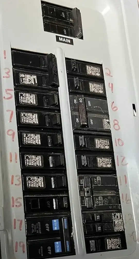

My plan was to relocate the two 60 amp sub-panel breakers down to make room for the 30amp generator breaker in position 2&4 to allow the main breaker interlock to operate. [See photo of partial work where relocated them to 6&8, 14&16 from 2&4, 6&8]

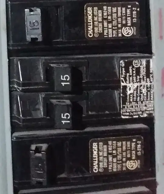

However, I've since learned that this box appears to NOT allow the use of tandem breakers, however one was previously installed [photo below].

  1. Is it okay to position the two 60 amp sub-panel breakers lower on the panel?

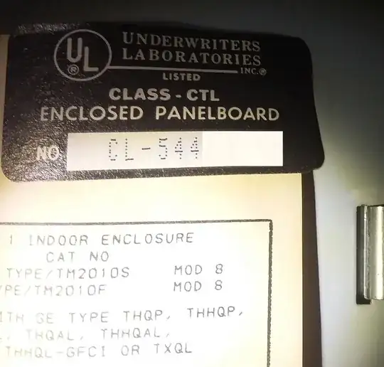

  2. Can tandem breakers be used? (The panel states use of THQP [half width] breakers is allowed)

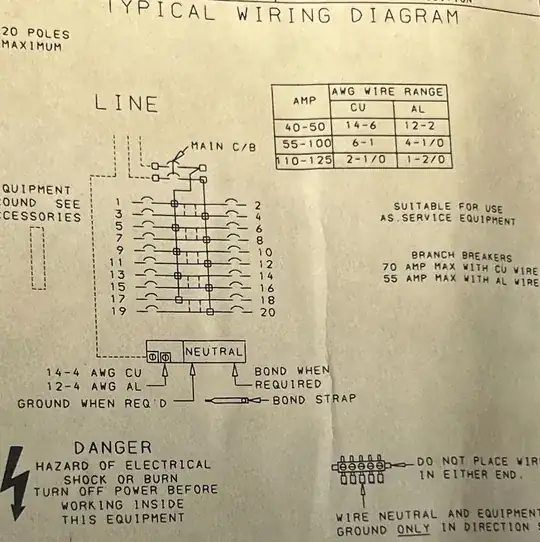

GE Panel Description Panel photo enter image description here Panel wiring diagram

Use THQL and THQP breakers, like the label says
This will afford ample opportunity to access the full 40-pole capacity of this panel.
  • BR and QP breakers do not belong in this panel.
  • Type C breakers do not belong in any panel, as they cheated their UL Listing and do not trip when they should.
  • The two 60A breakers appear to be GE and that's fine. The mystery breaker on lower left costs $7 to replace so I would just do that.

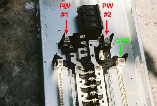

Edit to add photo: odd little cruciforms found where a GE panel supports thin THQP breakers. Photo from electrical-forensics.com
