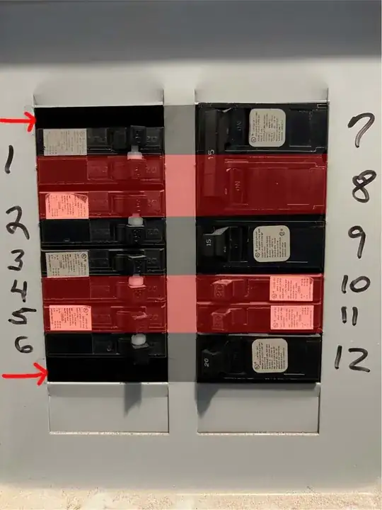

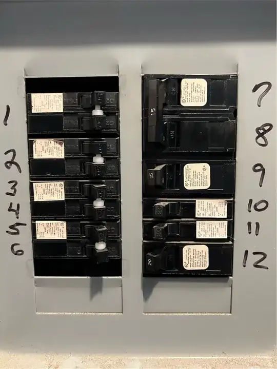

Here’s a pic: pic of panel

You can tell by how the panel is phased.
Service panels have their 2 phases (poles, really) laid out in a very particular way.
You have a GE panel. It's a little odd, but still decipherable. Let me stripe it for you like in the link.
Yup, 5 and 6 are on opposite poles. Note how GE does double-stuffing a bit different. Note also the Code violations; the empty holes at breaker 0 and 6-1/4 need to be filled with GE approved blank plates. The easiest-to-find models of blank plate are THQP115 and THQP120, which are also breakers LOL.
Now, watch Technology Connections' video on how we use 120V and 240V, and particulary his measurements on how breakers are phased. I cued it up for you. Notice how breakers on opposite poles are 240V from each other. Don't open your panel; you don't own that house.
So now it's a simple affair. If you can just measure voltage from the hot terminal of the microwave from the hot terminal of any other candidate socket... if the voltage difference is around 0 volts, it's on the same pole of the MWBC. If it's around 240V, it's on the opposite pole. Mark your receptacles in some manner.
To measure at a socket, just insert the UL listed and 600V rated voltmeter probe into the hot terminal. On a NEMA 5-15 or 5-20 socket, you already know ground... neutral is the taller one (or T-shaped one). The other one is hot.
