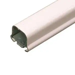

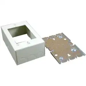

You need to bring a regular, properly installed power line to the projector. This can be properly installed NM cable inside a wall to an outlet box. It can be surface wiring, but this requires standard metalic surface channels and boxes such as this and this:
wiremold wiremoldbox
