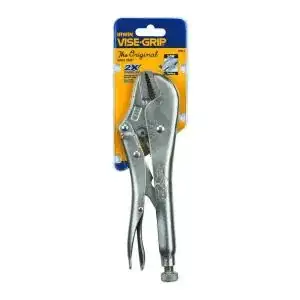

If you can grab the edges of the screw head with a locking pliers (such as Vise-grip), you can twist the screw out.
visegrip
If not, you can use an electric drill to remove thw whole screw head. Choose a bit that is slightly larger than the screw shaft (check one of the other screws you removed). Drill straight through the middle of the damaged screw slot. The border of the screw head will fall away. After the cabinet is down, you can remove the shaft of the screw with the locking pliers.
